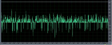

I'm using MSP430F5528 for audio ADC sampling. Since my sample rate is 16kHz, and data is stored in wave file format, I use ADC12 2's complement data format, left aligned. After reading a sample value I store it in LSB,MSB order. This samples are read in audio editors as 16 bit, instead of 12.
Following picture shows a silent part of my file. It is obvious that something is wrong, audio should be equaly distributed around zero point, but in my case majority of nonzero samples have positive values, only few are negative, and seams like there is some cutoff at zero point.
I guess it's something to do with those 4bits always being zero and sample representation, but can't figure out what am I doing wrong. Do you have any idea?
  • Are you "tying" ADC input to VREF/2 correctly? Please tell about ADC input circuit. Also picture is too small to see numbers on vertical axis to estimate noise amplitude. Could you provide shorter "recording", but with numbers on axis that we can see?

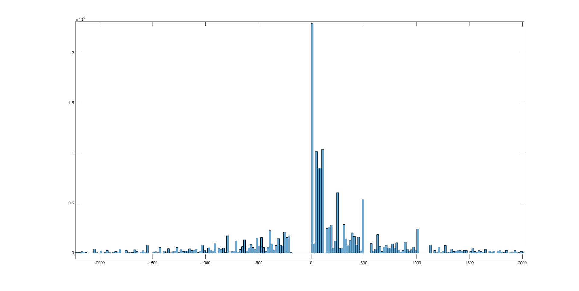

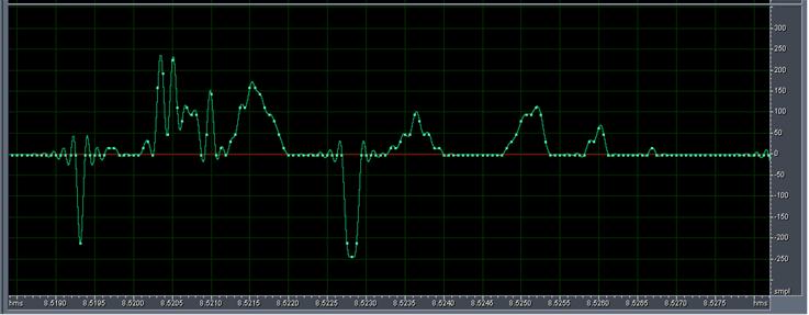

    Here is a 'zoomed' picture of the recording you asked (one channel, second looks the same). Please take into account the left alignment, which adds 16 times amplification. And also, this is silence in my office, not in anechoic chamber, so there is some ambient noise present.
    The problem I see are continued zero points and some sample values never present, you will see that on the histogram below.
  • > DC offset is only 0.005%, I think it's acceptable
    Sure. DC offset is "don't care" as long as you are fighting with uneven distribution of ADC/preamp input noise. When you are done with it - only then you shall think of either hardware or software offset compensation, if any necessary.
    No good. You shall disconnect mic and ground preamp input. You shall provide ADC data of just preamp and ADC noise, not random ambient noise of for god' s sake, EMI of your room.

  • Ok, Ilmars,
    I did what you asked, here is a file recorded with no mic and preamp input grounded: /cfs-file/__key/communityserver-discussions-components-files/166/silence.wav
    In past 2 days I recorded continuously on 5 devices (almost 10h of recording on each). These recordings contain my speech, music from a radio, car driving, and also a silence in anechoic chamber. Then I did analysis. None of this files contains sample values close to zero in negative domain (FFF, FFE,..., FF8 – in file: F0FF, E0FF,..., 80FF), not a single sample. This is actually seen on the first wave form I sent. No audio signal is zeroed like that, no matter what kind of noise is present. That’s why I sent a file with input, but low signal level (silence in my room). It is obvious that something is wrong with negatives close to zero, like they are all zeroed. I don’t get it.
