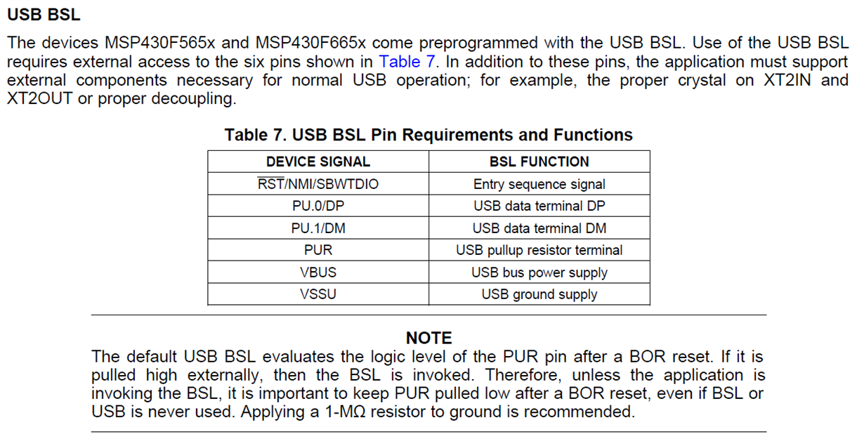

Does MSP430F5659 has boot loader( USB BSL) for firmware upgrade?
If not how to achieve this?
Whether any changes required in USB device side for firmware upgrade?
Nitesh
  • Hi Nitesh!
    The MSP430F5659 has USB BSL preprogrammed - this is from the datasheet:
    Dennis
  • Thanks, We are using USB with HUB in our design for firmware upgrade by command based approach, where our application will jump to 0x1000 for the upgrade on command.
    Will this approach will work will firmware upgrade application (python based TI Application ) right.
    Please comment
    Nitesh
