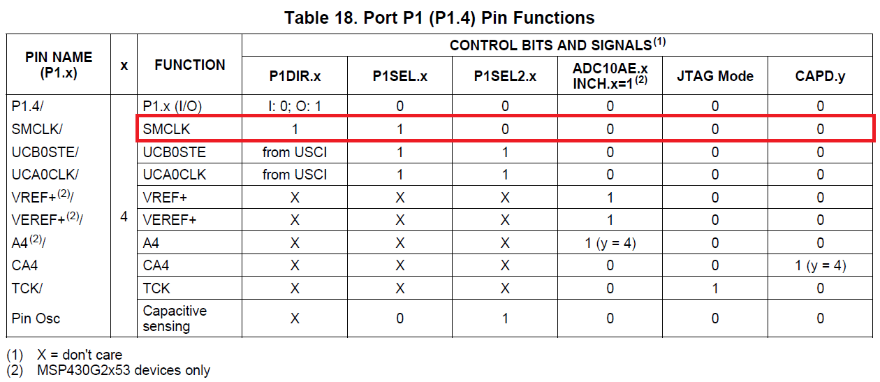

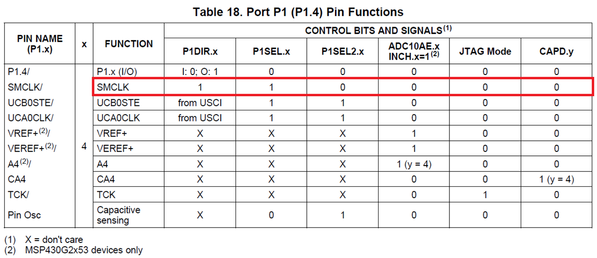

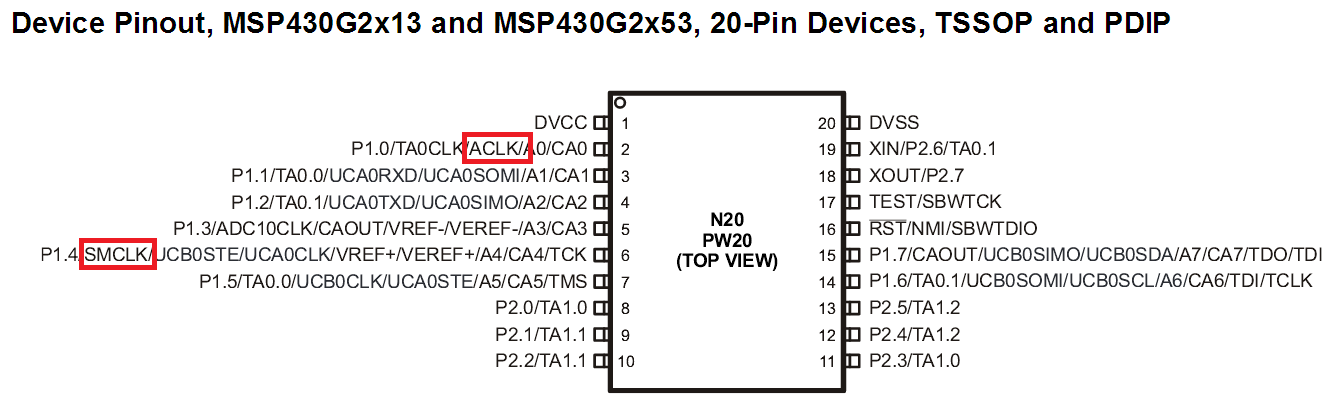

Hi Kavitha!
For the MSP430G2553 SMCLK is available as a special function at P1.4 and ACLK on P1.0:
To make these clocks available, you have to configure the pins accordingly. For SMCLK this requires to
P1DIR |= 0x10;
P1SEL |= 0x10;
Now SMCLK is available at P1.4 of the device. The datasheet has a table that shows what to do in order to use a specific function of a pin:
