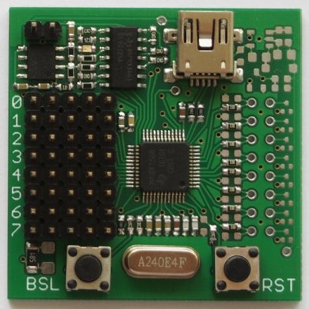

  • BTW, if you are using SBW, than my SBW+ flasher (MSP-GANG like) support serialization, and it is faster than MSP-GANG.
    Serial number (double word) with target address is stored in file and updated automatically. Example with inital line "01800 876BFFFC" from "serial.txt" file.
    C:\msp430>flash -f test_msp430f5510.txt -e -w -v -einfo -ser serial.txt

    Yes.
    In SBW+ (3 wires) slow mode, it is faster than MSP-GANG on full JTAG (6 wires) with max speed. In SBW+ fast mode, smart write for 5xx/6xx flash devices can go up to 200 KByte/s. There is no dll / layers, and PC side / interface is open (source), working on Win / Linux / OS X.
