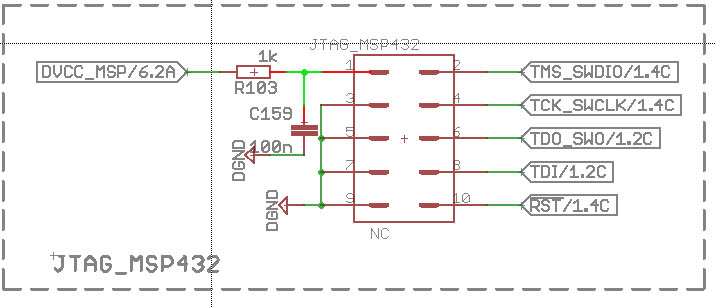

    It seems i have made some mistakle in creating my Breakout board. I now post the schematics, as I don't find the errors. The set up is as follows:
    I have a main board with the MSP432P401R attached to it and have a 10-pin 1.27mm header (like that one from the launchpad). I used the circuit connection from the launchpad schematic:
    since I cannot connect to the TI-14Pin from the XDS100v2 debugger I created a breakout board according to the pin out from your wiki:
    as i compare the pinout, i don't see the error. There is also no mix up in the signals from header to socket. So i don't get it, but obviously there's something wrong.

  • Hi Benni,
    I have not seen this type of error before. Are you connecting the XDS100v2 to a custom board or TI EVM? Please refer to the MSP432 Hardware Tools User's Guide (SLAU571a), which shows the relationship between the ARM 10/20-pin connectors on the MSP-TS432PZ100 schematic as well as supplying the MSP-FET-432ADPTR schematic for converting the MSP-FET connector to ARM 10/20-pin.

  • Hey Ryan,
    thanks for your help, I will check the user guide. I am using a custom made board, but you see my connections in the schematics above. The breakout board connects the ARM-10 with the TI-14.

  • maybe there lies exactly the problem: The ARM-10 uses only Vcc sense from the Debugger, but in my custom board I connected that pin via 1k Ohm to DVcc, like in the launchpad schematics.

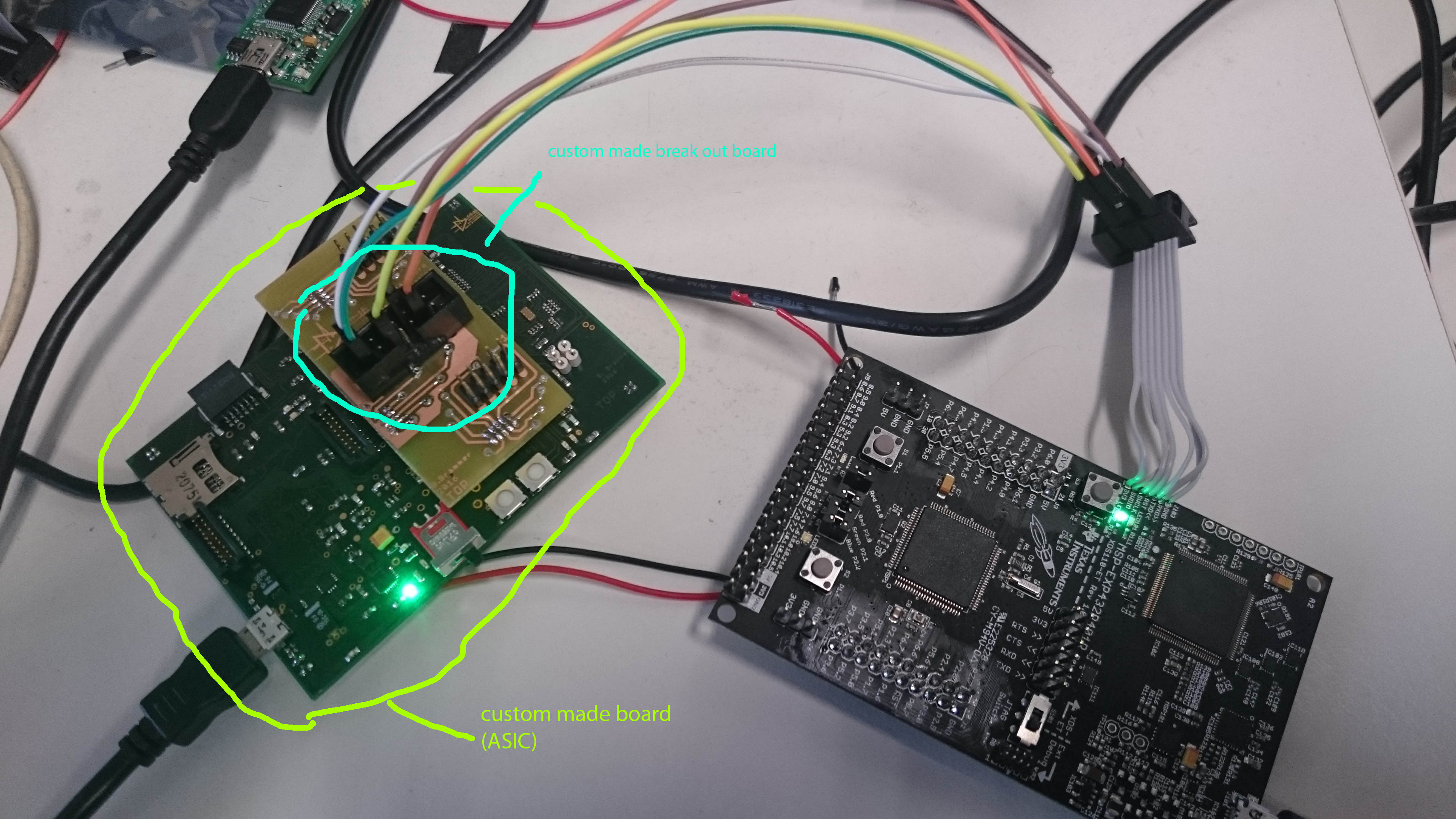

  •  Hey Ryan,
    after I checked really every possible error and found none, I used the evaluation board XDS110 debuger in SWO together with my custom board and the breakout board. Everything works fine, so there might be something wrong with the XDS100v2 debugger. I am using the latest CCS Version, this shouldn't be a porblem for the XDS100v2, or? here's a foto of my set up:
  • Benjamin,
    Are you aware, based on your picture and the test pins you're connected to on the MSP-EXP432P401R, that you are attempting to program the TM4C129ENCPDT used for the XDS110-ET as compared to using the EXT Debug pins on the opposite side of the board meant to program the MSP432P401R?

  • Sorry, what? I don't understand your answer.
    I am using the Launchpad's XDS110 debugger to debug my custom MSP432 board and it works absolutely fine just like it is descirebd in your MSP432P401R LaunchPad Development Kit (MSP-EXP432P401R) User's Guide (Rev. A).
    I have nothing to do with the TM4C129ENCPDT. I am using SWO. The opposite ARM-10 connector is to acces the MSP432P401R on the launchpad, but obviously i don't want that.

  • No problem, I have to apologize, since you're true. The XDS110 uses the TM4C129ENCPDT
    I will try to check with spectrum digital considering the XDS100v2. But so far debugging with the XDS110 works absolutely fine.

  • Ok. I checked if the Launchpad is stil working properly on its own, and yes it does. So I searched a little bit and finally found the important clue why the SDX100v2 doesn't work.
    In a similar post here in the forum ony guy managed to find the problem on his own: It's the TDIS pin. Sadly there is no marked hint on the TI wikis that if you use the xds100v2 probe on custom boards you'll have to set TDIS to GND otherwise the emulator will not work properly. I fixed that prblem and got a successfull verification of the Debug-probe.
