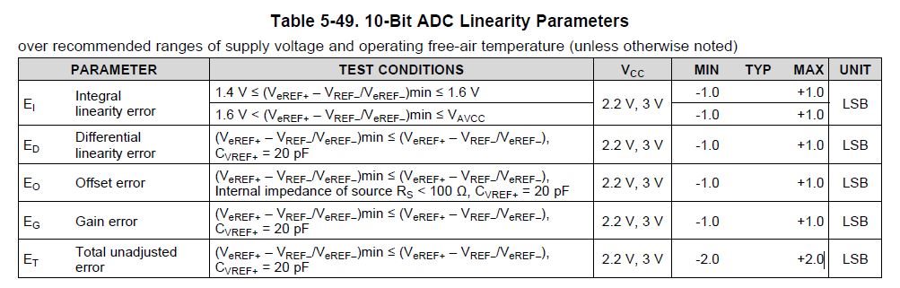

Can anyone say the worst case (exact) resolution of the 10 bit ADC in MCU?
Also can anyone explain the below table?

The resolution of a 10-bit ADC is 10 bits. You are probably concerned about the precision or accuracy instead.
The ADC outputs values in the range 0…1023. The LSB is the least-significant bit, i.e., the bit with the value 1.
An error of ±2 LSB corresponds to 2/1024th of the full range (i.e., an error of 1/512th of the voltage between VREF+ and VREF−).
