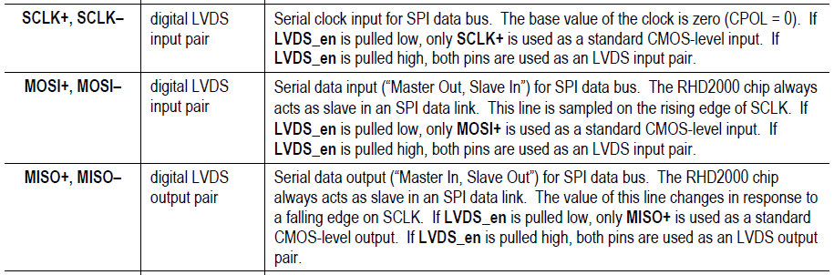

    I agree to Rob C...I also don't understand your situation. Maybe you have a wrong idea about SPI? Look at the datasheet of your device - it says the following:
    "The RHD2000 chip always acts as slave in an SPI data link."
    This means it will never output any data if there is no clock provided by the master (your MSP). So clock in 8 bits and grab the first half of the data, then clock in another 8 bits and grab the second half. Once you have both bytes, combine them to a 16 bit word or do whatever you want with the two bytes.

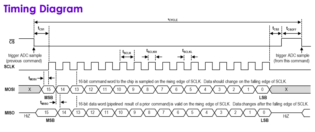

  • I think tha you are not understanding the problem. To improve the situation I sent a picture of the data sheet RHD2132 which shows how it works the 16-bit SPI communication.
    I don´t need to send 8 bits, then a dead time and finaly the other 8 bits, I need to send 16-bit, all together. Because the MSP432 isn't abel to receive the 16 bits by default.
    Do you understand the problem?
    Santiago.

    two eight bit transmissions act as a sixteen bit transmission. The slave doesn't care if there is a small pause in between. SPI is eight bits per default (USI can handle sixteen) and every transmission diagram in a datasheet looks like yours, but since the communication is controlled by the master, two consecutive eight bit transmissions is how it is done.
    Dennis

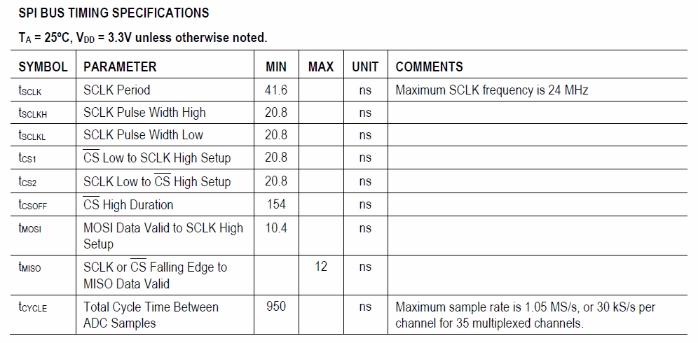

  • To confirm what Dennis wrote above, check the timing specification table in the datasheet:
    As you can see, there is no specified maximum for SCLK period, or high/low pulse width. There's no specified requirement for the clock period to stay consistent throughout a transfer either. This means it's fine to have a "long" clock cycle between the first and second byte.

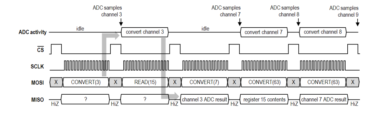

  • Yes, there is. I admit that I forget to mention many things, even some I passed me like this:
    The RHD2132 has no internal clock. It uses the SPI CLK for to do its internal operations.
    As the figure shows, RHD2132 uses the 16-byte cycles to convert analog to digital the measured channels. Perhaps, if  the communication is cut in two parts
    as you say, the RHD2132 cannot continue sampling the signal.

  • Hi Santiago!
    I wanted to answer that I doubt that, but a look into the datasheet confirmed it - the device uses the SPI clock for internal operations. It needs a few dummy writes on the bus to do the calibration, for example. Never saw this before. Anyway - it doesn't make a difference here. The dummy writes are consecutive eight bit writes as well.
    Santiago Radi said:
    Perhaps, if  the communication is cut in two parts as you say, the RHD2132 cannot continue sampling the signal.
    It will not stop, it only has the very small pause in between the two bytes, but you will not notice that. It is the same for every sample. The datasheet even recommends to add three auxiliary commands to be able to insert commands different than the CONVERT one while maintaining a fixed period for each round-robin command sequence. This means you will insert further delays.
    Santiago Radi said:
    So I would be interested to know if the MSP432 can receive 16 bits together.
    It will never receive sixteen bits in one cycle because the receive buffer is only eight bits wide. The DMA mentioned by Clemens will improve the transmission speed because it can move the data from the receive buffer to another memory location without the interruption of the program, but you do not necessarily need it here.

    I had a hard time believing this - most Cortex-M MCUs I know allow up to 24 bit at one transfer. However, checking the reference manual, this is correct. Not sure what drove TI's decision here, beside compatibility to a semi-paleolithic 16-bit core ...
    Yes, it can (send and receive) - as two separate, consecutive 8-bit transfers. As long as the MSP (master) does not pull the CS line up during transfer, that will not matter.
