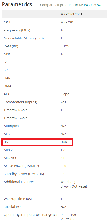

HI, ALL
Does MSP430F2001 have On-Chip ROM BSL?
I saw MSP430 Programming With the Bootloader(BSL) User's Guide(slau319l),
F2xx have On-chip ROM BSL in P4 Table 1 BSL Overview.
But there was no information about BSL in F20x1 Datasheet(slas491l)
Does MSP430F2001 have On-Chip BSL?
Which pin is BSL Function Pins If F2001 have BSL?
Must I make custom BSL?
Best Regards
Takashi
  • Hi Takashi!
    Although the parametric overview says it has UART BSL...
    ...I don't think it has BSL at all. This is the same for the other devices from that family (F2002, F2003, ...).
    Dennis
