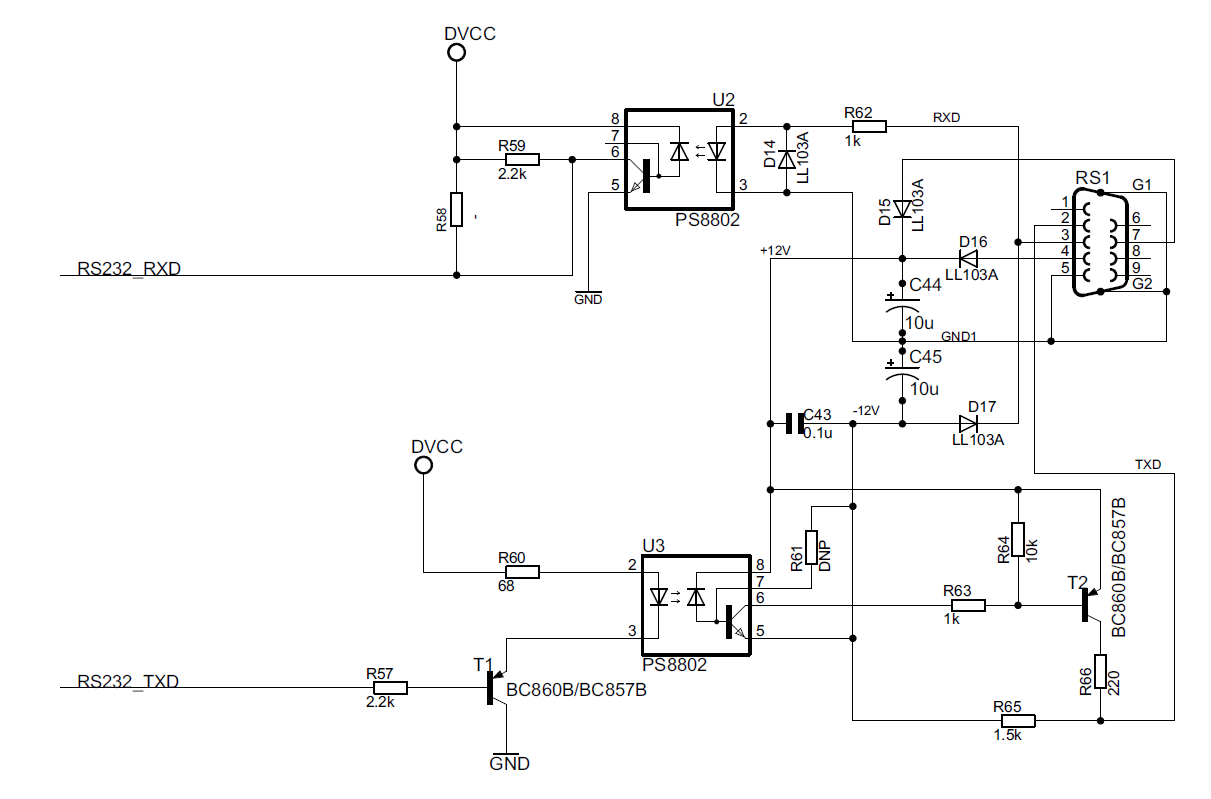

I'm trying to send commands from PC to EVM430F6736 via the onboard RS232 port, which is connected to UART1 on the MSP430F6736. For testing, I'm doing a loopback test but the command I'm sending is not being echoed back to the PC. Here are my codes:

For every character I send from Terminal in PC, I toggle the onboard green LED. This works which means receive is ok and the ISR is invoked. However, transmit does not seem to work because I am not receiving anything in the Terminal. Am I missing something?
