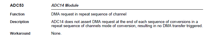

  • Hi Josue,
    Which MSP432 Launchpad version are you using?? RED (Silicon Rev C) or BLACK (Silicon Rev B)?? ( www.ti.com/.../msp-exp432p401r)
    David
  • The Black one (Silicon Rev B)
  • Hi Josue,
     This behavior is related to the Errata ADC53 and it got corrected on Rev C.
    I only made a couple of changes to your code and I got it to work with the Rev C.
      David
  • Hi DavilL, thanks you very much, so, the problem can not be solved on the Black silicon board??, where I can find the errata documentation, and what kind of changes do you made to the code??? the changes whre on the ADC configuration?? or DMA configuration??
    both of them??, I thought that it was a problem of the DriverLib.

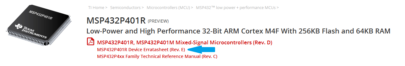

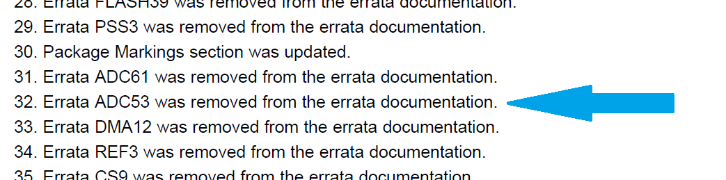

  • Hi Josue!
    The Erratasheet can be found here.
    You can find the link on the product webpage of the MSP432P401R:
    But it looks like the Erratasheet has lost almost all of it's content (issues fixed in silicon rev. C) - there are only four issues left and the one mentioned by David is no longer present:
    Dennis
