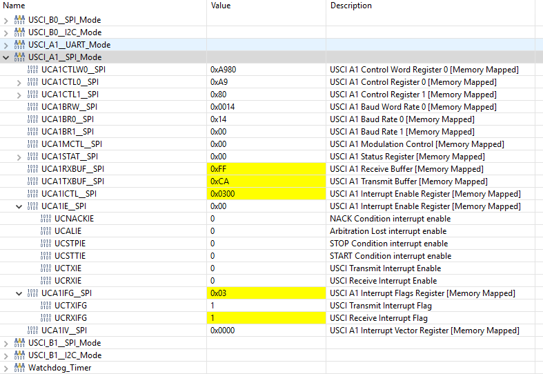

After that I tried send one byte by following code (I know about non-true "wait-busy" approach, it's only example ):
//Waiting buffer is ready
while (!USCI_A_SPI_getInterruptStatus(USCI_A1_BASE, UCTXIFG));
//Transmit data to slave device
USCI_A_SPI_transmitData(USCI_A1_BASE, 0xCA);
in Debug mode I get following picture:
As mention on the piscure UCTXIFG doesn't clear when data inserted in TX buffer and I received some data in RX buffer (which I not wating) and UCRXIFG set.
To this time I checked port mapping of MCU, power, connection to the SPI device.
So I have question - what I'm doing wrong and which reasons may be when UCTXIFG doesn't automatically clear?
