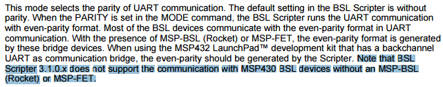

  • Hi friend,
    I copy the string of RX_PASSWORD command to MSP and send it to it using a terminal application.
    I had success using the following configuration of serial port : 9600, even ,8,1
    Apparently, the example application was configurated in the worng way.
    Finally, my test worked, calling the BSL from anywhere of my firmware.
    Thanks for your help.
