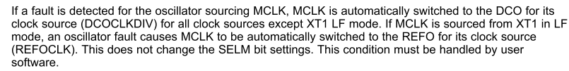

Hello TI employee,
    I want to know if the following circumstance occurs,  and software don't modify the SELM bit setting or SELA bit setting, will it be a hidden bug?
  • It would be a bug only if your application does not work correctly with the fallback clock source (DCO/REFO).
    (But if your application does work with the fallback, why did you try to use the crystal in the first place?)
