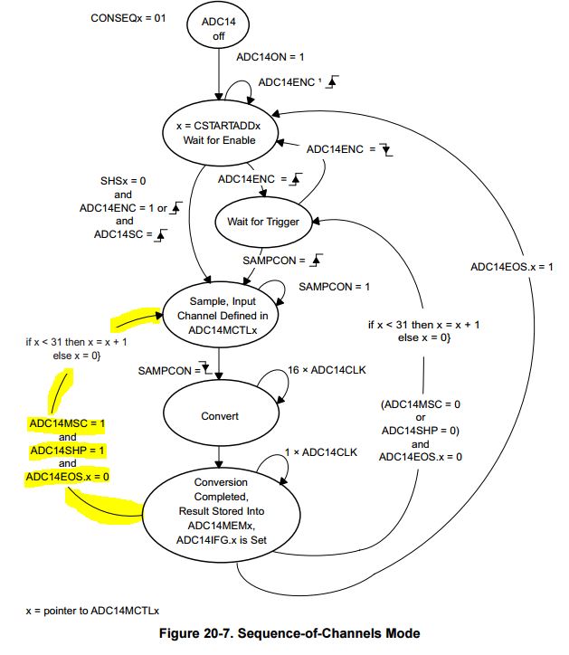

msp432 adc14 stop single channel repeat mode
hi,
i would want that adc14 of msp432 start to sampling at time = 0 and finish to time 1000 microsecond. This is my part of code interested:

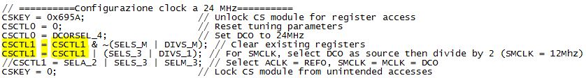

// ========== clock a 12 MHz==========
CSKEY = 0x695A;                    // Unlock CS module for register access
CSCTL0 = 0;                        // Reset tuning parameters
CSCTL0 = DCORSEL_3;                // Set DCO to 12MHz (nominal, center of 8-16MHz range)
CSCTL1 = SELA_2 | SELS_3 | SELM_3; // Select ACLK = REFO, SMCLK = MCLK = DCO
CSKEY = 0;                         // Lock CS module from unintended accesses

I don't know how stop conversion and sampling of adc14 because with this step it samples to 1200microsecond and doesn't stop at 1000
  • Dear Luca,
    I am looking into an example that takes advantace of the timer triggering the ADC and utilizing the ADC interrupt instead of polling the IFG within the timer ISR. I think this will help greatly with the timing. Also, I noticed that the timer is in 'up' mode and uses a value of '5' in the CCR0. Please be advised that the timer period is actually 5+1 because of the extra clock cycle to count from 5 to 0. So the actual timer period is 6 SMCLK cycles instead of 5.
    I hope to get back to you within the next day with an example.
    Chris
  • oh wow i didn't know that!! So you think is better using adc14isrInterrupt? and if i make that, how i controll the sampling of adc? Here i have a frequency of 1/5us but using adc interrupt? Then how can i solve the problem of step (ccr0) = 5? i have to change time setting previuous step? for example TIME_ON = 45? thanks and sorry for my bad english
  • Luca,
    Please find the attached logic photo and example code.  I had to increase the clock frequency to 24Mhz to prevent any missing conversions.  There were instances where the time spent in the ISR was too long and consequently either did not support the 1/5us sampling rate or in the case of using the ADC interrupt, multiple interrupts would occur and the previous sample was overwritten before it could be read.
    I removed the send commands in the timer ISR and this might become an issue when you re-apply them because of the amount of time. You can further increase the MCLK frequency to 48Mhz and make the appropriate changes to the Vcore and waitstates per the example provided (see also datasheet and code example for 48Mhz operation).  In the code I put in a couple of traps so that you would be able to tell fairly easily if there was a timing issue and you are missing samples.
    I hope that helps.
    Chris
        CS->KEY = CS_KEY_VAL;                                    // Unlock CS module for register access
        CS->CTL0 = 0;
        CS->CTL0 = CS_CTL0_DCORSEL_4;        // Set DCO to 24MHz
    //    CS->CTL0 = CS_CTL0_DCORSEL_3;        // Set DCO to 12MHz (nominal, center of 8-16MHz range)
        CS->CTL1 = CS_CTL1_SELA__REFOCLK | CS_CTL1_SELS__DCOCLK | CS_CTL1_SELM__DCOCLK; // Select ACLK = REFO, SMCLK = MCLK = DCO
        CS->CLKEN |= CS_CLKEN_MODOSC_EN;
        CS->KEY = 0;                         // Lock CS module from unintended accesses

  • i don't understand a thing. If a want change the time of ADC trig? for example start to sampling at another time (from 200 to 1ms) because time on is changed to 400 and time off to 600. the code helps me but it is written in a different form from mine. the funcion send_all_values() is for send values to server so i need it because after a cycle it starts another with same time.
    i don't understand the time*TA0CLK_MHZ.
    i don't understand this void TA0_off() {TIMER_A0->CCTL[0] &= ~CCIE;} //enable interrupt - does not stop timer
    sorry for questions, if you want we can write on facebook
  • i used 12Mhz because, if it is correct, the serial comunication need this.
  • Luca,
    Let me try and address each of your questions:
    (1) I have increased the DCO to 24Mhz which is configured to source both MCLK and SMCLK. You can divide SMCLK in the Clock System Module (CSCTL1 Register, Field DIVS) to maintain the SMCLK frequency you want and still have MCLK at 24Mhz so that the ISRs execute in a timely fashion.
    (2) The TA0CLK_MHZ was intended to scale the timer values based upon the timer clock selected. In your case it is simply 12/12, so that 1 timer clock is 1us. If the timer clock was 12Mhz (no divider) then the timer multiplier would be 12. Then the STEP value would be 60 and at 12Mhz the step would still be 5us. The intent of the definition is to maintain the 5us step regardless of the timer clock frequency.
    (3) The function TA0_off() is a function that I do not understand. By clearing the CCIE, the timer is not off, only the interrupt is disabled. I was concerned that you thought this was actually stopping the timer.
    (4) In the application that I provided the enable convert, ENC, is set immediately (line 171). Similar to what you did previously, when microsecondi reaches the desired value you can set ENC. There are a couple of different ways that you could approach this, I think the key is to minimize the amount of time in the ISRs.
    (5) The form of the code is CMSIS as opposed to the classic MSP430 style.
    Hope that helps,
    Chris
    sorry for late. I think it's better post al code so you can have a complete idea of my work. Msp is connected with a dust sensor of sharp. This sensor has IR led that i can turn on or off when i want (it's that i make in Time_ON and OFF). In this period i have to read the analogi signal (A14) during turn on of IR that indicates the presence of dust in the air. Because i'm doing different experiment of period of IR_ON i want read the signal in different times ok? So maybe start adc at 0 and finish at 1ms or change and start adc at 200us because IR turns on later and finish adc read before (for example 800us). The ir can be turned on for a time i want. (200us, 400us etc...).
    Now the code is connected with a program in Python that starts the program manually or automatically. This part of code works for me and i have no problems. It is base on exchange of letters that define command. In msp i have the function sendallvalues that send values of array to my server. To make this i have to have a serial connection with (i think) 24Mhz of clock. For this my question about DCO.
    Now with the log i noted that timerA counts perfectly the time with step dedicated and not Step+1 as you think. So why make step-1? (see image below).
    I don't understand the two values of ccr0 and ccr1. Why use thes and not one?
    I need the function sendAllValues so at TIME_save this is called.When the array is full index_N = 0 but you have commented this row. Where i make the call of function and control of index array?
    With the code below i note that time is perfect but maybe the adc (as you said me) don't works correctly in ISRtimer for the high frequency. So what i want is only have a correct utilization of adc triggered by ISR timer that dictate the steps of code.
    RTC is used if it works in automatically mode. This works for me.
    Only thing i want is that adc start and finish his operation in time i want and fills array to send in serial comunication.
    Sorry for lot of messages and thanks for help!!!! :) :) :)

  • Maybe the problem can be the setting of SHP bit that is determined by adc14sht0x (clock cycles)???
    the strange thing is that if i keep adc14 sampling into isr timer, it takes values. If i use isrADC interrupt the values are very low and wrong, i'm sure. So i don't know what do. Sorry for the long post, i understand if you want to go on holiday ahah
    In a precedent post you write me: "
    ADC14->MCTL[0] = ADC14_MCTLN_VRSEL_0 | ADC14_MCTLN_INCH_14; // A14 ADC input select; Vref=AVCC=3.3V
    // with a setting of 14, the conversion takes 16 clocks, the default ADC clock is MODCLOCK, ~25Mhz
    // 20 clocks at 25Mhz -> 800ns
    Another thing: i have tried to set DCO at 24MHZ because you wrote me "I had to increase the clock frequency to 24Mhz to prevent any missing conversions.  There were instances where the time spent in the ISR was too long and consequently either did not support the 1/5us sampling rate or in the case of using the ADC interrupt, multiple interrupts would occur and the previous sample was overwritten before it could be read. " But for serial comunication i need 12MHZ. I tried to use divs field (divs_1) to divide 2. But it doesn't work.
    Maybe is this? CS->CLKEN |= CS_CLKEN_MODOSC_EN;

    Since we want to use SMCLK for TimerA0 and UART, we just need to change a few lines of code in main(), as shown below. Moving forward, I'd recommend that you update your code accordingly before we continue tackling the ADC. This should allow your serial communication to work now.

    Please let me know if you were able to measure 12 MHz at P4.3 and then if your serial communication works.
    James
    MSP Customer Applications
  • Hi James,
    I'll try it now :) I modify only this part without see the adc part so i'm sure that serial communication works. One part for time. When i have done i'll write here. One question: in my python program i set serial communication with 9600baud. Is it ok with this change also? Do you need python program to make test?
    Thanks for all!!!
    Luca
  • It works!!! Ok the problem about SMCLK = 12Mhz and DCO = 24Mhz resolved!!
    Now we can pass to ADC problem i think :) If you need this is code loaded on msp now. If you see, i have void ADC14_IRQHandler(void) for use interrupt but first i used the if statement. (if(microsecondi > TIME_ADC_START && microsecondi <= TIME_ADC_END) ) with all part of sampling and memorization of value from buffer to array. What is correct or better? I'll wait your idea ;)

    My idea is start and end adc sampling and conversion in ADC_START and ADC_END. With if statement it works (i see it with log that send me the time), but it seems that there is no time for complete conversion or sampling. I note this because the values of adc are very low when it's near IR_OFF while it should be costant. (IR is a led of dust sensor). Maybe i don't use correct method. When you can, explain me. The frequency of adc sampling has to be 1/STEP where step can be 10us,5us... For now assume that STEP=5us. (in the code is set to 10, sorry)
    Maybe i have to set adc14ssel to use correct clock of adc? I'll wait your answer :)

  • hi, when you are free we can see the adc part and solve it :) i think i am near to solve the problem but i need your help :)
    See my precedent answer to have idea with my code and if there is solution setting adc14ssel or adc14msc bit. Then another question: why we choose 24mhz? if step was higher 12mhz was ok?
    thanks
  • Hi Luca,
    I'm sorry I haven't had a chance to dig into the ADC part yet, but I'll plan on looking at it tomorrow. Thanks for your patience.
    James
  • Ok don't worry, i wait you :)
    Meantime i send you my updated code.
    Using SMCLK as adc14 clock (12Mhz), a resolution of 14bit (so 16 clock cycles for conversion ), a step of 10us:
    • i have set ADC14SHT0_4 (64 clock cycles for sample and hold) --> 64+16/12 = 6.67us (it is < 10us so it should be good).
    • If i use STEP = 5us i think to use ADC14SHT0_x higher or use DCO clock (24Mhz).
    question:
    1. i use conseq_2 (single channel repeat sequence). But if i set adc14msc bit my program doesn't work. Why?
    2. Is it better use smclk or dco clock as source for adc?
    3. have i to set ADC14CLRIFGR0 |= ADC14IFG0;?
    4. tell me if the code is set right (ADC14_IRQHandler, TimerA0_0IsrHandler etc... i remember that i need the function sendallvalues to send values to server).
    5. If set step = 5 i have 200samples. step=10 i have 100samples... (is it possible use step = 2us?)

    	// ==========Configurazione clock a 24 MHz==========
    	CSCTL0 = DCORSEL_4;                // Set DCO to 24MHz
    	CSCTL1 = CSCTL1 & ~(SELS_M | DIVS_M); // Clear existing registers
    	CSCTL1 = CSCTL1 | (SELS_3 | DIVS_1); // For SMCLK, select DCO as source then divide by 2 (SMCLK = 12Mhz)
    	//CSCTL1 = SELA_2 | SELS_3 | SELM_3; // Select ACLK = REFO, SMCLK = MCLK = DCO
    You're correctly using CONSEQx = 2 for repeat-single-channel mode. ADC14MSC should be set, which selects Pulse Sample Mode and uses the sampling timer. After looking at your code, you need to also set the ADC14SHT0x and ADC14SHT1x bits in ADC14CTL0. Please read Section 20.2.6.2 in the TRM and refer to the 'msp432p401_adc14_06' code example. NOTE: Like Chris already mentioned, it looks like you're still using "=" instead of "|=" for some registers, and this could cause some problems for your ADC configuration. Also, I see that you're calling ADC14CTL0 |= ADC14SC each time you enter your timer ISR - this isn't necessary in Pulse Sample Mode. Please see how this mode allows you to continue to sample, convert, store, then back up to sample as shown in the state diagram in Figure 20-8 in the TRM.
    My suggestion would be to use the lowest possible clock frequency that meets your requirements to achieve the lowest possible power. Since the minimum sample time is dependent on several parameters mentioned above, the conversion time would be faster with a faster SMCLK. If you use the Pulse Sample Mode and use TimerA at the beginning and end of 1000 microseconds, you may be able to go back to using the 12 MHz DCO configuration. Chris correctly recommended that you increase the DCO frequency because the ISR was taking too long in that case.

    In the code example, the ADC14_CTL0_MSC bit is set, which allows multiple sample and conversion to be performed automatically. If you don't use the MSC bit, you may have to manually trigger the next sample. Take a look at Figure 20-7 in the TRM to know how the ADC operates when CONSEQx = 2. As you can see, after the conversion has been completed and stored in memory buffer, sampling occurs automatically (when ADC14MSC = 1 and ADC14SHP = 1 and ADC14EOS.x = 0).
