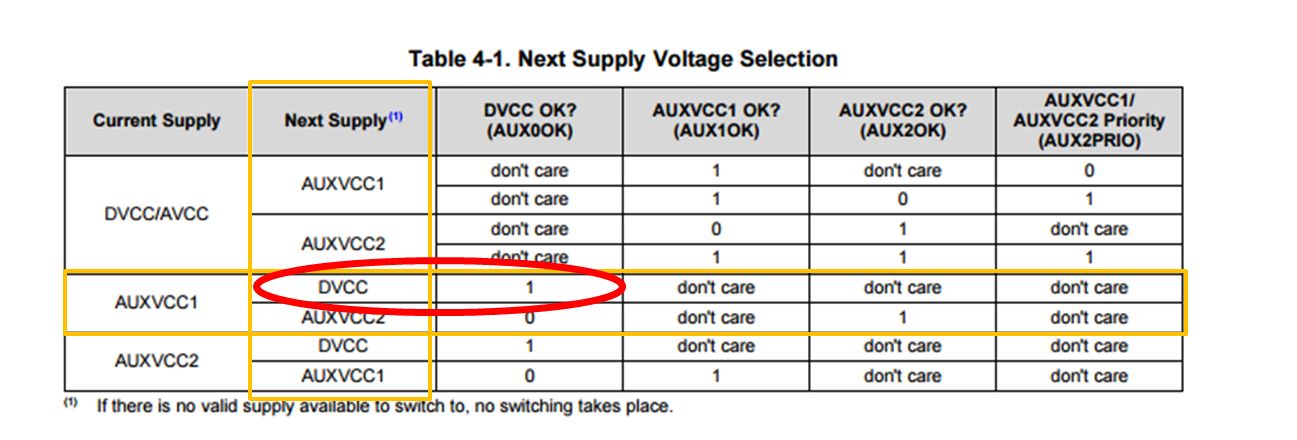

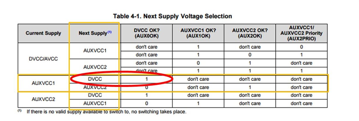

    I have an additional question about table4-1.
    Your first reply, you said that ' the current supply is DVCC/AVCC instead of AUXVCC1 in which case the AUX0OK bit is in a "don't care" state.'
    My test condition  is as follows,
    1. DVCC/AVCC is gone. then AUXVCC1 is current supply. (AUX0OK is 0)
    2. AUXVCC1's voltage under 3.0V. then AUX1OK is 0.
    3. Then, DVCC/AVCC comeback. It become over 3.0V.
    My understand is,
     I have to see the column, Current Supply is AUXVCC1, Next Supply is DVCC  correct?
     Then, I see [DVCC OK?]  column,  it is 1.  This means, if AUX0OK bit is 1, it can switch next supply.
    Please see attached JPEG.
     But, you said 'AUX0OK bit is  in a "don't care" state'. I cannot understand your explain.
     Could you please teach me more details?
    Shinji Ueda
  • AUX0OK is only in a "don't care" state when DVCC/AVCC is the current supply. In the test case you mention AUXVCC1 is the supply so we now care about the status of DVCC. Nothing I have stated conflicts with Table 4-1.
