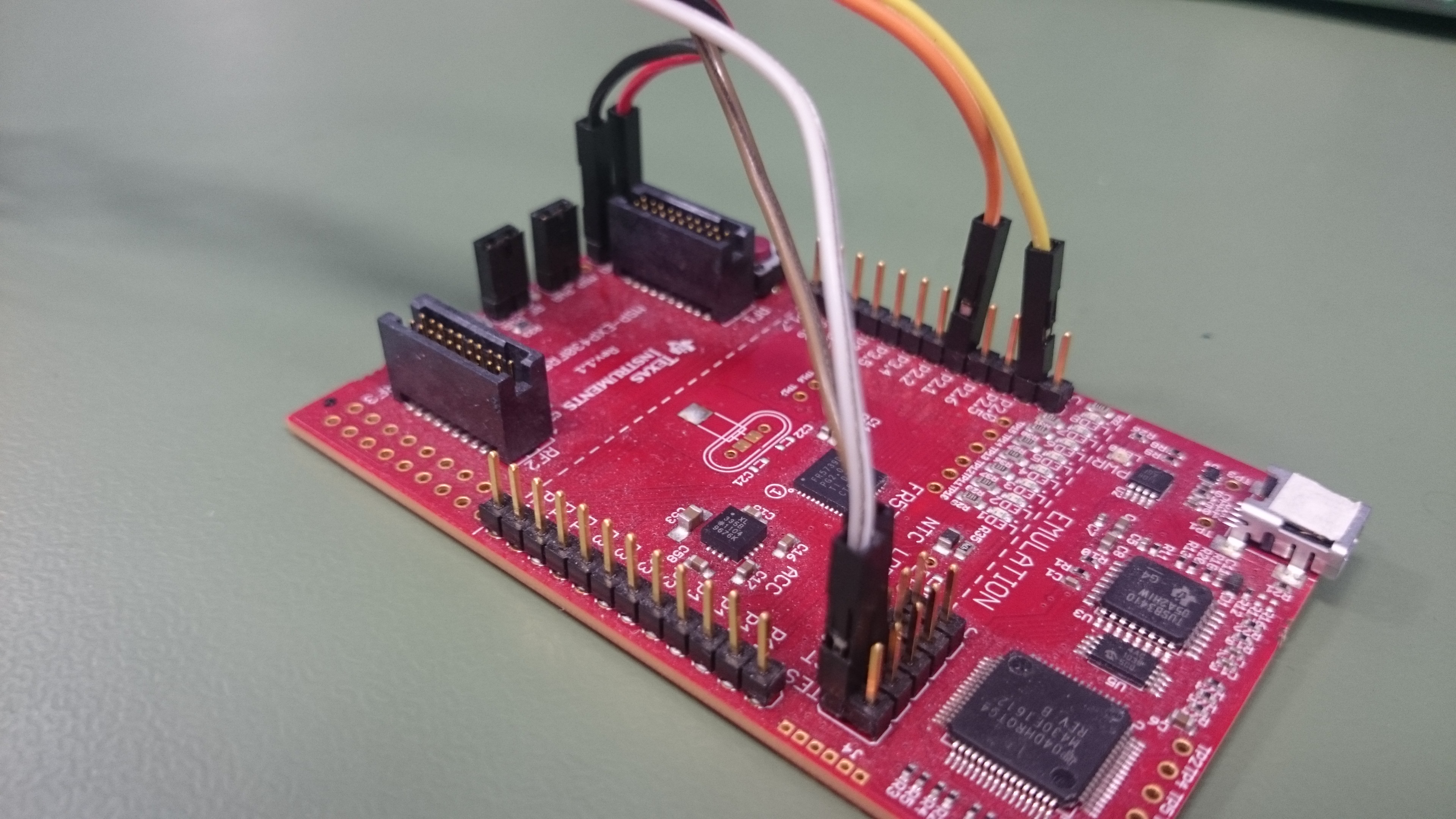

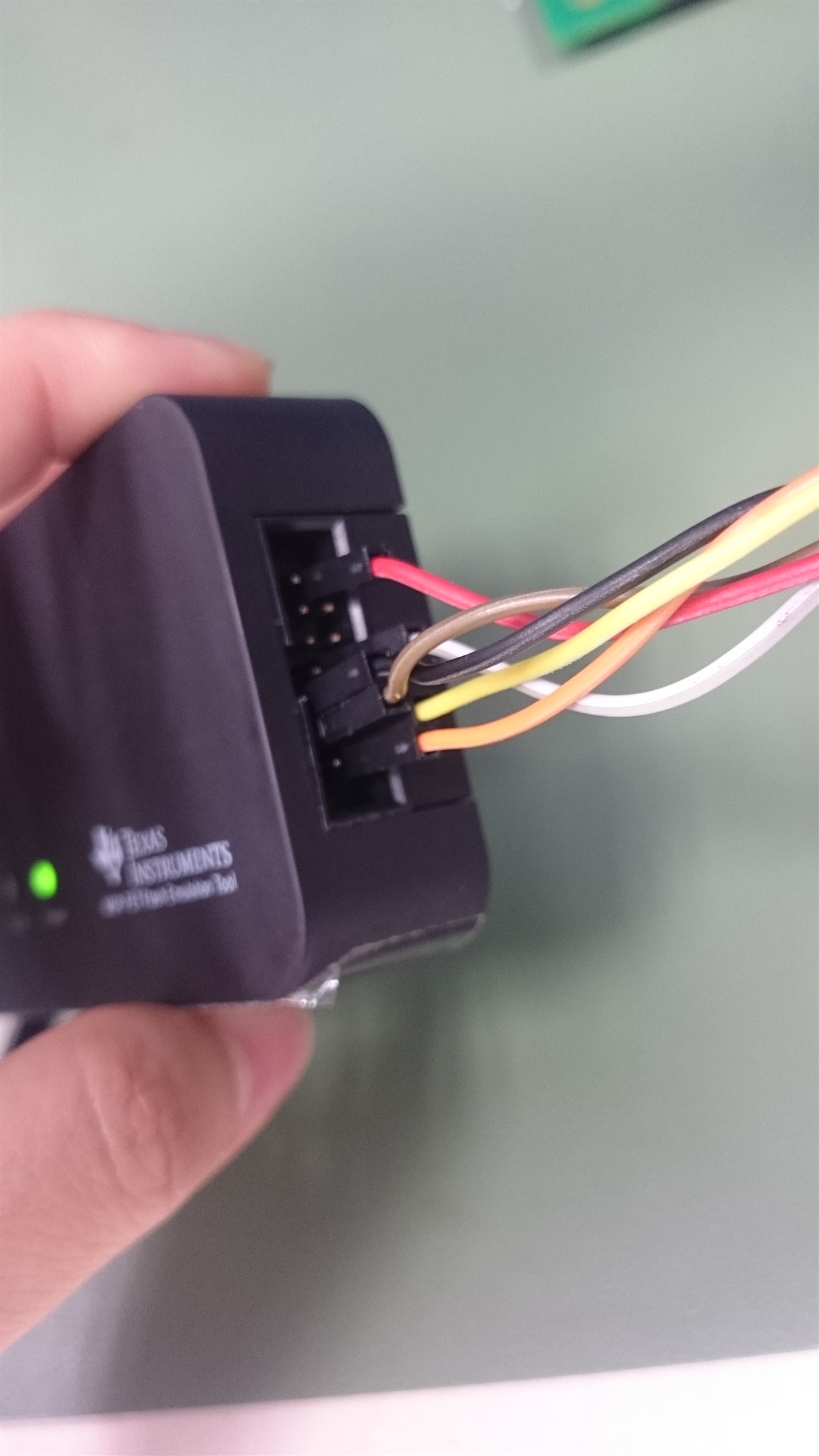

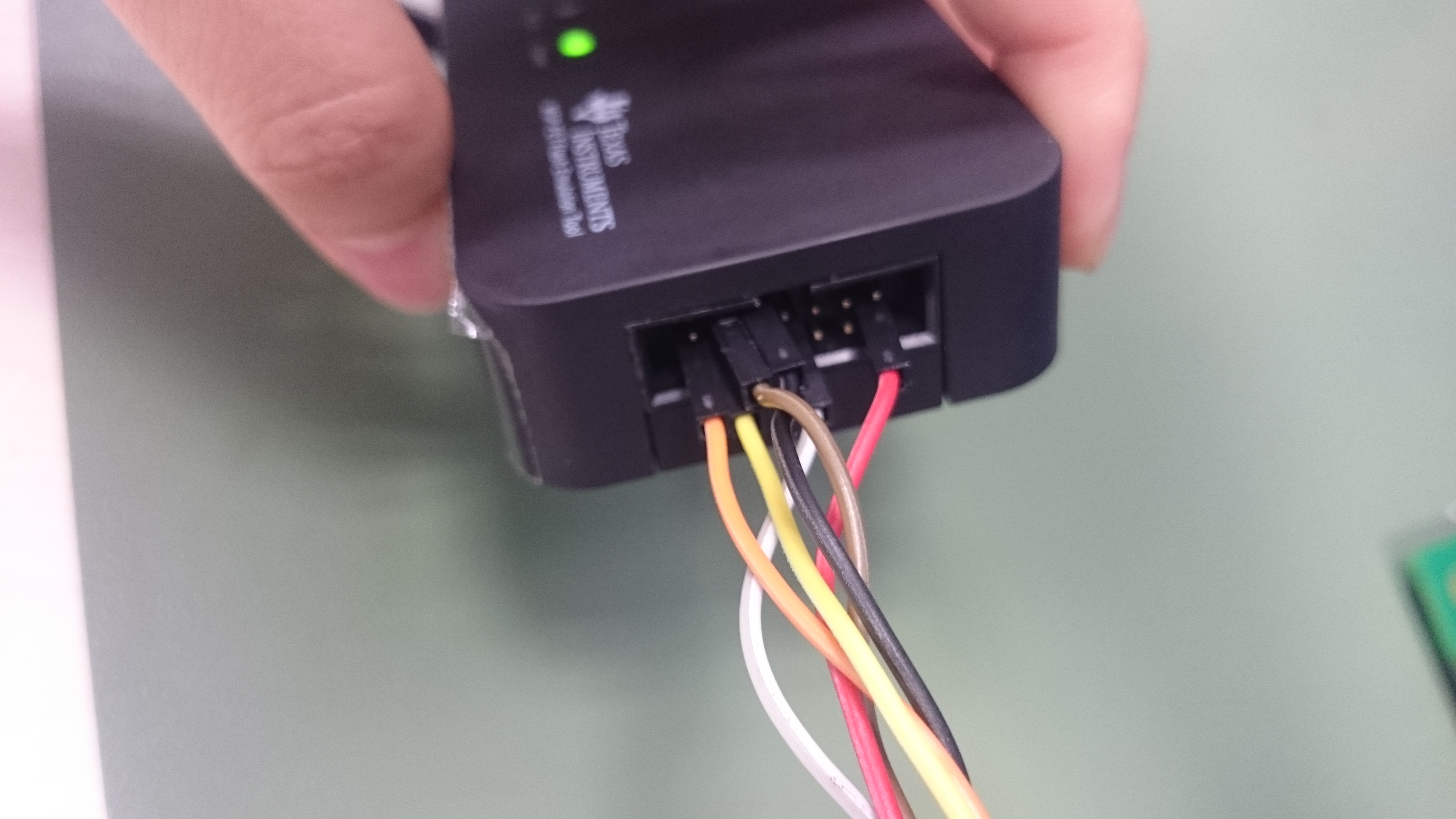

  • Understood. I also ran into this issue. I have reached out the the BSL-Scripter team and will let you know their feedback when available.
  • NIrmal,
    I have now been able to program the FR5739 FraunchPad with MSP-FET using BSL-Scripter. Please see the following simple script for details. Also, please check HW connections between Fraunchpad and MSPFET. For BSL usage, the target must be connected to the MSP FET via Test & RESET pins. This is not the same configuration that SBW uses.
    HW Connection Example:
    Simple Script:
    LOG
    //COM Port must be BackChannel UART  (Application)
    MODE FRxx UART COM61
    RX_PASSWORD pass32_wrong.txt
    DELAY 2000
    RX_PASSWORD pass32_default.txt
    //Simple Blinky Example not included
    RX_DATA_BLOCK Blink_FR57xx.txt
    CRC_CHECK 0x4400 0x0020
    SET_PC 0x4400
