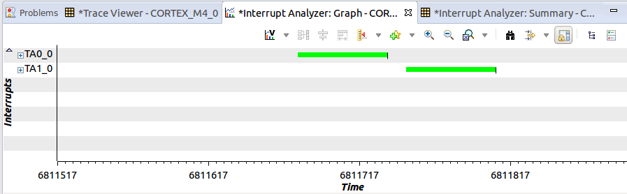

I'm trying to understand how interrupt profiling configuration of hardware trace analyzer in CCS works on an example code.
In this example, Timer A0 and Timer A1 are configured with the same settings (up mode is selected, both TA0CCR0 and TA1CCR0 are set to the same value).
I explicitly put a delay loop into TA1_0_IRQHandler to show that if interrupts are overlapped (while one is served and the other is pending).
However, I never saw such a situation from the data captured over serial wire debug port.
Did I make a mistake inside my code or serial wire debug interface is not capable of such things (i.e., the capture rate is not fast enough)?

    TA0CCTL0 = CCIE;                          // TACCR0 interrupt enabled
    TA0CCR0 = 0;
    TA0CTL = TASSEL__SMCLK | MC__UP;   // SMCLK, continuous mode
    TA0CCTL0 &= ~CCIFG;
    NVIC->ISER[0] = 1 << ((TA0_0_IRQn) & 31);
    // TA1
    TA1CCTL0 = CCIE;                          // TACCR1 interrupt enabled
    TA1CCR0 = 0;
    TA1CTL = TASSEL__SMCLK | MC__UP;   // SMCLK, continuous mode
    TA1CCTL0 &= ~CCIFG;
    TA1CCTL0 = CCIE;                          // TACCR0 interrupt enabled
    NVIC->ISER[0] |= 1 << ((TA1_0_IRQn) & 31);
    SCB->SCR |= SCB_SCR_SLEEPONEXIT_Msk;              // Enable sleep on exit from ISR
    __enable_interrupt();
    TA0CCR0 = TA0CCR0_VAL;
    TA1CCR0 = TA1CCR0_VAL;
    while (1)
        __sleep();
        __no_operation();                         // For debugger
// Timer A0 interrupt service routine
void TA0_0_IRQHandler(void) {
    TA0CCTL0 &= ~CCIFG;
    P1OUT ^= BIT0;
    //TA0CCR0 = TA0CCR0_VAL;                       // Add Offset to TACCR0
// Timer A1 interrupt service routine
void TA1_0_IRQHandler(void) {
    TA1CCTL0 &= ~CCIFG;
    P2OUT ^= BIT0;
    //TA1CCR0 = TA1CCR0_VAL;                       // Add Offset to TACCR0
    for(i = 5000; i > 0; i--);

  • Hi Abdullah,
    I did not get similar results when using CCS v6.1.3 and MSP-EXP432P401 Rev B silicon, the TA1 interrupt would be longer than TA0 by the amount determined by the for loop which I reduced from 5000 to 10 to get the following result.
    Are you using the same setup that I've described?  Have you changed anything from its default setting?
    Regards, Ryan
  • Hi Ryan,
    I noticed that Timer A1 ISR should take longer than Timer A0 ISR. Now I fixed this issue and get similar results like you.
    My question is that if this code makes these two interrupts occur at the same time.
    If it does, why we cannot see such situations via serial wire debug interface? There is always a gap between two ISRs.
    My intend is to use this tool to explain the interrupt priority to our students in practice.
  • Hello Abdullah,
    TA0 takes priority over TA1 and is therefore serviced first, this is followed by a short delay while the CPU exits the first ISR to enter the second. No exception entries have been set inside of the NVIC to preempt the TA0 ISR in the instance that TA1 is currently being serviced, therefore TA0 will not interrupt the TA1 while it is mid-ISR. Interrupt priorities and exception entries can be set using the NVIC, which is explained in the device user's guide (SLAU356).
    Ryan
  • OK. Thanks for your explanation.
