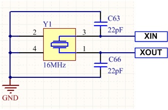

Good afternoon,
I want to write and read for a SRAM memory (23LC1024) to 16 MHz SPI by using the MSP430F249. However, the maximum transmission rate that I am able to obtain is 8 MHz.
Can you help me with this problem?
SPI 8 MHz configuration (is functioning well):
P3DIR |= 0x01;
P3OUT |= 0x01;
P3SEL |= 0x0E;
UCB0CTL1 |= UCSWRST;
UCB0CTL0 |= UCCKPH + UCMSB + UCMST + UCMODE_0 + UCSYNC;
UCB0CTL0 &= ~UCCKPL;
UCB0CTL0 &= ~UC7BIT;
UCB0CTL1 |= UCSSEL_1;
UCB0BR0 |= 0x02; //16MHz / 2 = 8MHz
UCB0BR1 = 0;
UCB0CTL1 &= ~UCSWRST;
Timing chart:
SPI 16 MHz configuration (is failing):
P3DIR |= 0x01;
P3OUT |= 0x01;
P3SEL |= 0x0E;
UCB0BR0 |= 0x01; //16MHz
UCB0BR1 = 0;
