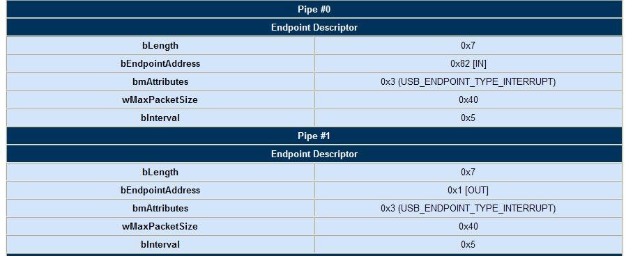

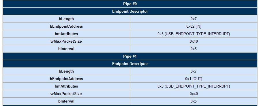

  • Yes, USB Descriptor Tool can't do this.
    Here is a picture my friend show me.What does it means?  It looks like EP1 for OUT and EP2 for IN?

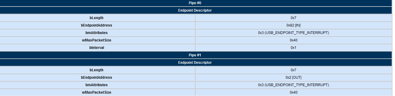

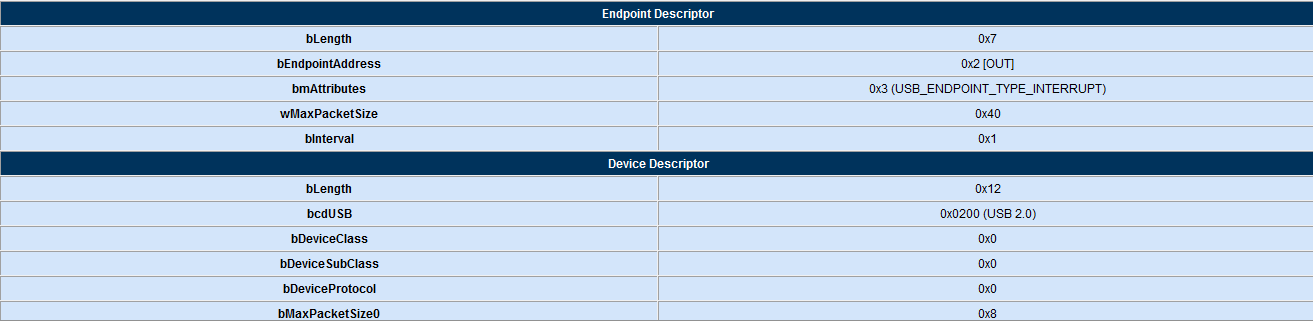

    Above is the info of device run changed demo  shows.
    When i use GUI to send command LED ON!   It says
    Connected to device VID: 8263 PID: 769
    TX-->LED ON!
    Unable to send buffer!
    So there still some things i missed maybe.
  • edb_Index is the index in the USB buffer descriptor register array, i.e., the endpoint number minus one. It's used for both endpoints, so TI's USB stack does not support the output and input endpoints of a single HID interface to have different endpoint numbers.
  • Thank you so much. I successfully use EP2 with your help. Thank you again.
