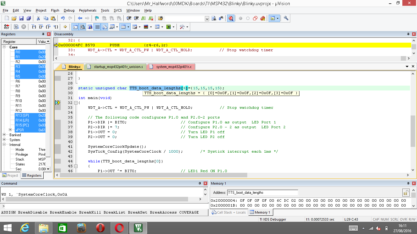

    I added the following to the Blinky example, and added a reference to the array to avoid getting a warning about an unused variable:
    static unsigned char TTS_boot_data_lengths[4]={15,15,15,15};
    The uVision debugger showed that the TTS_boot_data_lengths array had been initialized with the expected values. The only quirk of the debugger I noticed was that if you hover the cursor over the TTS_boot_data_lengths array, without selecting the array name, the tooltip incorrectly reports the first value in the array is 0x0:
    Whereas if you select the TTS_boot_data_lengths variable in the editor the tooltip then shows the expected values:
    The Memory window displays the expected contents of the TTS_boot_data_lengths array in both cases.
