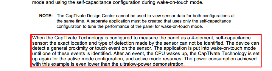

64-Button Capacitive Touch with CapTIvate
in TI's reference design (64-Button Capacitive Touch with CapTIvate),it demonstrate that  every touch pad can be used to active the system,
and it need two separate projects designed by CapTivate design Center to gernerate source code,
but  how can i combine two project source code  generated by the CapTivate design Center?
  • In the NOTE above (found on page 11 in the Design Guide), it mentions that the CapTIvate Design Center can only be used to view sensor data for one configuration at a time (either wake-on-touch mode or standard mode). Thus, two separate projects for these modes are needed when using the Design Center. When you're not using the Design Center, both modes can be implemented in a single project for your application.
    James
    MSP Customer Applications
  • yes i have done that , after combine two project together ,it can not enter low power mode,
    i modified the CAPT_App.c and  CAPT_UserConfig.c  as the file attached bellow:
    am i right ,
    is there any user guid that i can do it step by step?
