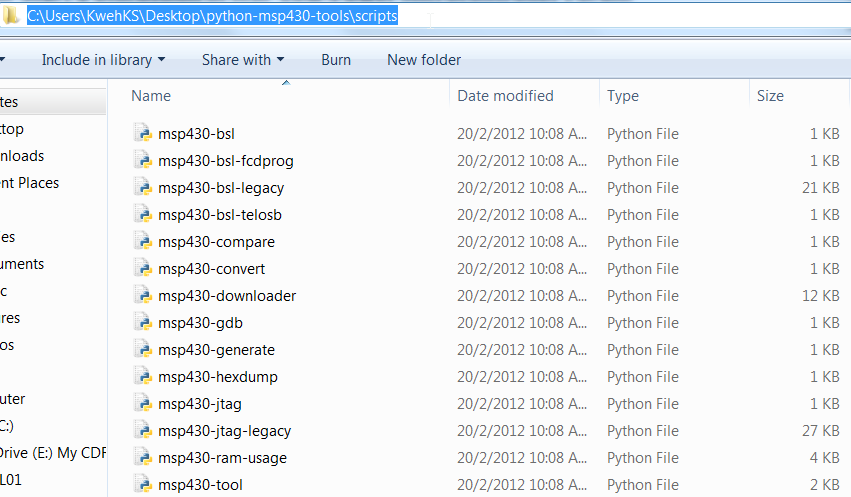

error: file 'C:\Users\KwehKS\Desktop\python-msp430-tools\scripts\msp430-bsl' doe
s not exist
Does anyone solve this issue mind to show me what wrong with this installation?because i check the file is exist.Thank you.

    This seems to be a bug (discussed here). The workaround seems to adding the '.py' extension to the script paths in 'setup.py'. I've attached a patch below for your reference (found here). I'm wondering if this occurs because you're using Windows instead of Linux, since Linux executables typically don't have extensions.
    https://e2e.ti.com/cfs-file/__key/communityserver-discussions-components-files/166/python_2D00_msp430_2D00_tools.patch
    If this workaround doesn't work, perhaps you can try installing as an administrator using "sudo" before the commands. If this doesn't work, you could try installing a Linux virtual machine on your Windows PC or using a Linux computer to see if you can successfully install it.
    Keep in mind that "python-msp430-tools" is not an official TI tool. For your reference, we do offer an open source MSPBSL library (found here) and tool (found here) for Windows.

  • Yes, it's worked. Thank you very much.
