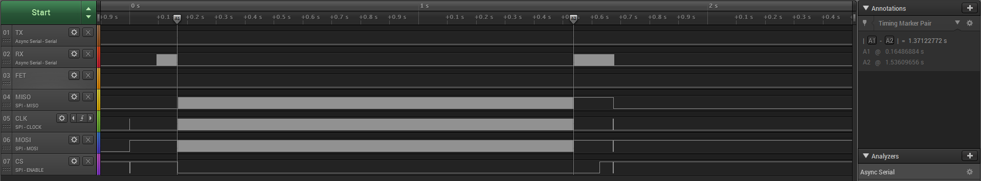

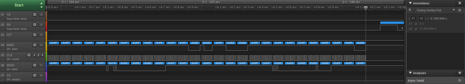

I am trying to integrate Chan's FatFS on the MSP430FR5969 designed into a custom PCB. I am able to initialize the SD card (put it into Idle State, then put it into run mode). The issue I am having is when I have the MSP-FET connected, I have three problems:
- It takes about 1.3 seconds for the SD card to go into run mode (it should take hundreds of milliseconds)
- The data received from the SD Card indicates a SDSC, when the card is actually an SDHC
- Once initialized, the SD Card returns an invalid command to a read block request
I post this here because when I remove the MSP-FET, the SD card:
- Initializes in 0.14 seconds
- Reports back as SDHC
- Allows Block Request commands
I'm wondering if this has to do with clocking from the MSP-FET, or some setting that I can change (hopefully). It's going to be difficult to debug from here out if I have to disconnect my debug tool every time.
