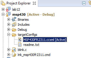

We are currently developping a board with a MSP430FR2311IPW20R and are having difficulties for the debuger to recgonize this chip. We are using the FET DEBUGGER UIF. We have tested this debugger with a MSP430G2 Launchpad already and it work properly.
After building the project and trying to connect to the target with our MSP430FR2311IPW20R we get the following:
This is how CCS6  project looks like :
Hence, I suppose we have a hardware issue. The system is powered by a battery which voltage goes from 2V to 3V in running mode but we have used normal power supply which we set to 3.3V for target connection. We have tested that power is supplied properly to the MSP430FR2311IPW20R with 3.3V for loading firmward and testing the connection between the JTAG pin and the pin of the component with a continuity test.
