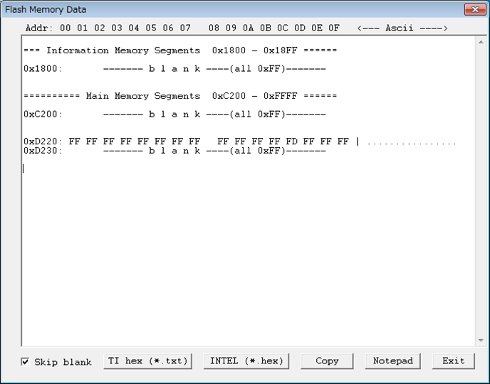

My customer has problem with flashing FRAM in MSP430FR5739 by Lite FET-Pro430 Elprotronic.
MSP430FR5739 is on customboard, the Fail occurs on some board (not all).
Details of operation is following.
It seems like it fails at "ERASE FLASH" and "BLANK CHECK".
But when doing "ERASE FLASH" after Fail, it goes well.
And do the "AUTO PROG" after "ERASE FLASH", it goes well too.
After some trials, my customer found 3 good ways.
1) "AUTO PROG" without "BLANK CHECK", this works fine.
2) "AUTO PROG" after "ERASE FLASH", this works fine too.
3) Only do "WRITE FLASH", this works fine too.
And the device(MSP430FR5739) which has been flashed well once, it would be flashed wuthout no Fails after that.
Do you know what the cause is ?

    I remember a similar case that was caused by a faulty supply connection between the FET and the target. This does not need to be the same here, but I would check proper connections first, just to be sure. Back then, the Vcc line did not have contact and it looked like during a few tries to access the device the capacitors on the target board got charged via the protection diodes of the MSP, finally having enough energy to establish a connection for a short time.
    Dennis
  • One plus for FRAM over Flash devices is that there is no need to "erase" it (write 0FFFFh to all location) before write. I will never understood people for "erasing" FRAM.
    Blank checking is another option (for flash devices) that is (for my point of view) irrelevant, because it doesn't guaranty that flash write after successful blank checking will be successful. Marginal read should be used for this.
