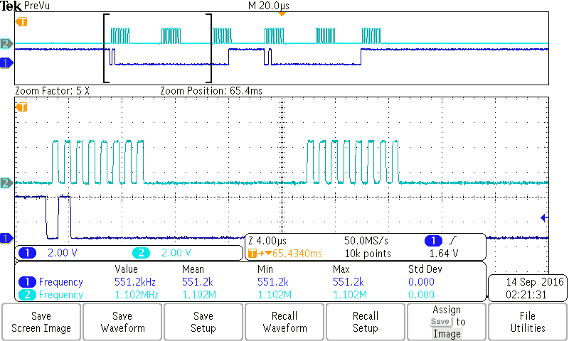

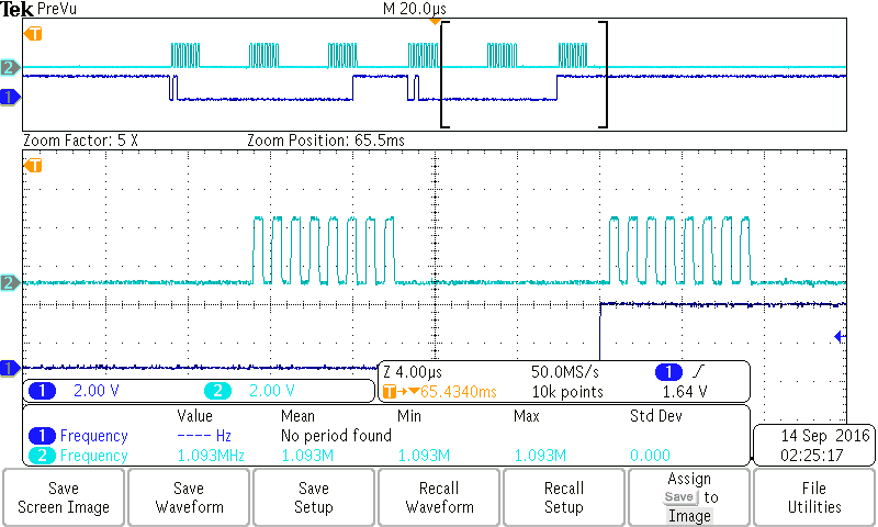

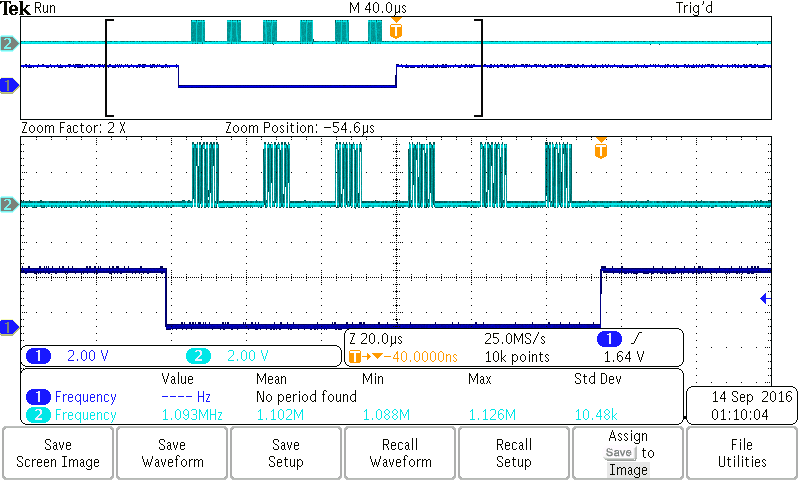

I'm interfacing MSP430F5529 launchpad with ADS1248 via SPI. I was monitoring the UCB0TXBUF and RXBUF registers while running CCS and found that only TXBUF is getting the values and RXBUF always return 0x00 whenever a register is read. I first want to have a setup where I can write and read back registers properly. Upon seeing the waveforms of SPI on DSO, I found that the SCLK gets turned off whenever RXBUF is being used to read data. Please help in solving this issue. Please find the attachments of code and the waveforms below.

SCLK (2) - CS (1) SIGNALS:
SCLK (2) - MOSI (1) SIGNALS:
SCLK (2)- MISO (1) SIGNALS:
Please let me know if further information is required.
