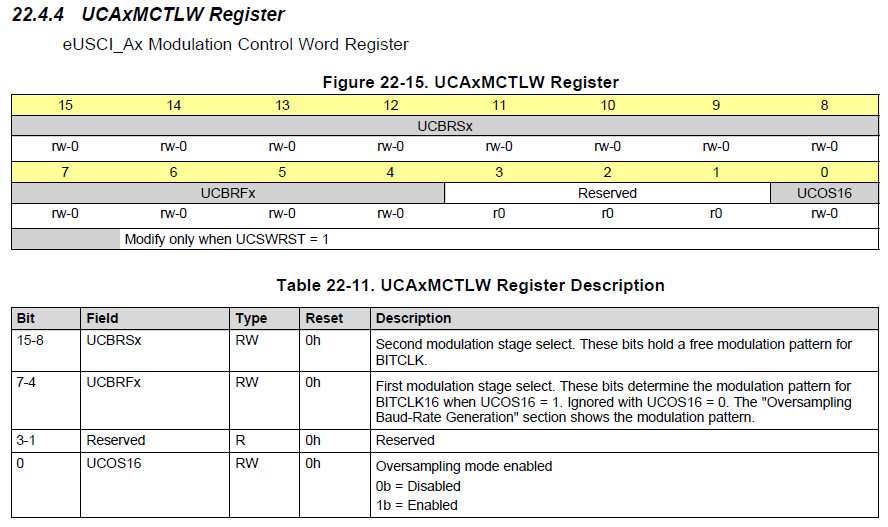

    2)If i want baudrate = 38400 i have (from table): UCOS16=1, UCBRx=19, UCBRFx=8, UCBRSx=0x65. Is it correct write as the code written below?
      // Configure UART
      UCA0CTLW0 |= UCSSEL__SMCLK;             // 12Mhz
      UCA0BR0 = 19;                           // 12000000/16/38400
      UCA0BR1 = 0x00;
      UCA0MCTLW = 0x6500 | UCOS16 | 0x0080;

    I did not test it, but from these tables...
    ...I would say it is:
    UCA0BRW   = 19; // Same as UCA0BR0 = 19; and UCA0BR1 = 0;
    UCA0MCTLW = (0x6500 | 0x0080 | UCOS16);
    Same as yours.
