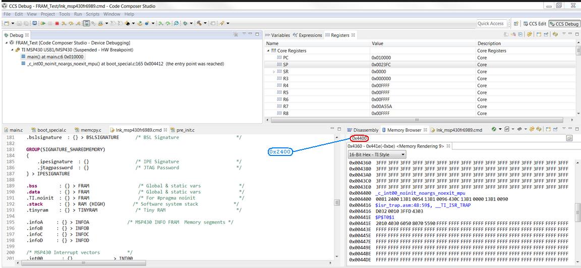

  • I am a little concerned about available SRAM, but more about I just want to see everything in FRAM because I would like everything to be there once it powers down, and I mean everything.
    I'm sorry for the confusion, when I say see them I mean follow "memory browser" inside of code composer. It lets me see all of the values of every single memory location inside of the MSP.
    I hope everyone can see this alright. On the bottom right is where I can see all of the memory locations. FRAM "starts" at 0x4400, with everything above it being SRAM. on the top right is all of the registers. It shows  the stack pointer address (currently at 0x0023FC (outside of FRAM).  The bottom left contains the linker I am trying to edit. I have edited lines 189 to 191. If I edit 192 so that it says FRAM it will start getting weird on me.
    When I say I see them in FRAM, I mean I see then in the memory address after 0x4400 (where FRAM starts for the MSP430FR6989). For example on line 0x0044IE on the bottom right, it has values of 2010 4030 ect ect. That was me saving an array of 10, 20, 30, 40 etc (just to see where it would go). When it comes to simple variables (such as uint8_t i = 0;) I will follow the assembly code and it appears to only be saving it to the Stack Pointer, nowhere else.
    Hopefully, this clears up some of what I was trying to say.

    On my particular device, FRAM starts at value 0x4400 (which can be seen on lines 3156 and beyond.
  • Unfortunatly, they is just a search bar. I just searched the address 0x4400 to look at FRAM. This is what it looks like if I search 0x2400
    0x0023E0 0046 0001 1122 AAAF 5604 0000 0062 0001 FFFF BCAB DECD FFEF 5511 4433 4416 0000
    0x002400 3FFF 3FFF 3FFF 3FFF 3FFF 3FFF 3FFF 3FFF 3FFF 3FFF 3FFF 3FFF 3FFF 3FFF 3FFF 3FFF
    0x002420 3FFF 3FFF 3FFF 3FFF 3FFF 3FFF 3FFF 3FFF 3FFF 3FFF 3FFF 3FFF 3FFF 3FFF 3FFF 3FFF
  • The SRAM is from 0x001C00 to 0x0023FF. So you actually can see the contents of SRAM in the Memory Browser.
    The first line, 0x0023E0 ..., shows the contents of last 32 bytes of the SRAM. Currently, the stack is in SRAM and the stack pointer is pointing at 0x0023FC. Hence the content of the stack is:
    0x0023FC 4416 0000
    only 4 bytes and nothing else. The rest of SRAM contends meaningless garbage. Your "variable in stack" are nowhere to be seen.
    The reason is, those variables are dynamically allocated in the stack as needed. They are nowhere at the time you use the Memory Browser. You need to do it during the "life-time" of those variables to see them.
    Now if you put the stack in FRAM instead of SRAM, the same thing will happen. It is no-better and no-worse.

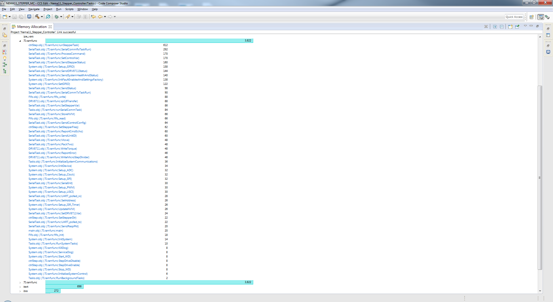

    Problem:
    The program has no issues until the code size is increased beyond some threshold.  Once larger than certain threshold, when running the debugger, it can not reach the Main entry point.
    Environment:
    The IPE is disabled via GUI project properties selection, the MPU is set to manaul settings, with every option selected (read/write/execute).  I see similar results with the MPU completely disabled when the code size is small enough for things to run properly.
    Cmd file:

    Here is the memory allocation when code size is small enough for everything to work, IE, run the debugger, and I can reach the Main entry point, code runs properly.
    Here expanded:
    Here entering Main just fine when debugging...
    Now, when i increase code size, things start to get weird...  Here is the memory allocation with code size slightly larger, and now NOT functioning properly....
    When running the debugger, the Main point is not reached and it sits here...
    So clicking on TI MSP430..(Running) and then "pause" to find the debugger stuck here...
    Also included below are the various points it appears the program traveled before getting stuck
    Now, I have read that you should overload system_pre_init() with WDHOLD, and i tried this, but this causes even worse behavior.  For example, in the case of the working size code, I add this function to my main file, and do nothing inside of it except return 1, and the code that was working, no longer works.  I also attempt to return 0, with similar results.  So if you see below, instead of adding a custom system_pre_init() function, which is not helping, i add a hold watch dog line to boot_special.c ...
    However, once running, probing the Watchdog register via REGISTERS, it does not seem like the bit is set, so any help is greatly appreciated.
