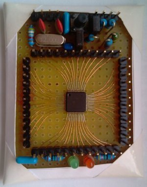

  • Tyler,
    My MSP430F5510 p2p board on picture is far away from USB design rules, and it is working (USB projects) for last 5 years without any problems.
    For resolving problems (regarding USB) on your board, forget you application, and test it with preloaded TI BSL (4, 8, 12 or 24 MHz XT2). Simply, erase it (with SBW / JTAG), and after power up, device will enter to BSL mode and should be enumerated as HID. You can test it with TI BSL software tools.
    BTW, My SBW+ flasher (MSP-GANG like) has included 2 CDC - Mailbox / UART / I2C bridges for debugging or data exchange. With used both bridges in full duplex, UART can go up to 1Mbps.
  • Zrno Soli,
    Thanks for the tips, I'll keep that in mind for my next USB design!
    I was able to achieve the 1.15Mbps throughput I was looking for by buffering my transfers and sending them in the background, so all is good.
