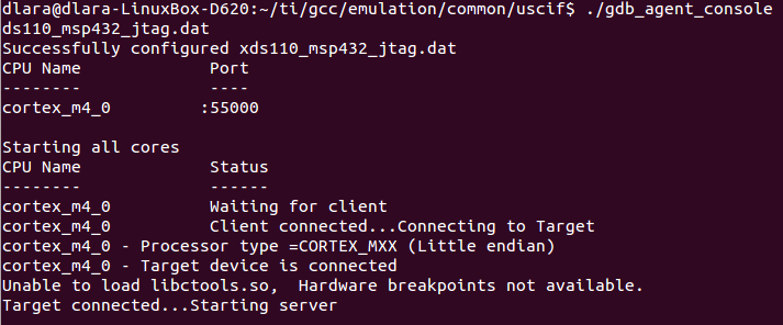

I've downloaded msp432-gcc-1.0.0.1-linux-support-package-installer.run and am trying to get the XDS110-ET on the MSP-EXP432P401R Launch Pad to work.
If I fire up gdb_agent_console with no LD_LIBRARY_PATH, I see the following...
No LD_LIBRARY_PATH
zot (16): ./gdb_agent_console xds110_msp432_jtag.dat
Successfully configured xds110_msp432_jtag.dat
CPU Name Port
cortex_m4_0 :55000
Starting all cores
CPU Name Status
cortex_m4_0 Waiting for client
cortex_m4_0 Client connected...Connecting to Target
cortex_m4_0 - Processor type =CORTEX_MXX (Little endian)
cortex_m4_0 - Target device is connected
Unable to load libctools.so, Hardware breakpoints not available.
Target connected...Starting server
Can't find libctools.so.

  • Hi Eric,
     I'm running Ubuntu 12.04 32 bit and with CCS v6.1.3 and I got a similar behavior.
    I can connect to the target, stop and run but I could not set any breakpoints.
    And I found out that some DLL are missing from the standalone package. A bug has been filed but I do not have a timeline on the resolution. please take a look at this thread e2e.ti.com/.../522572

  • I've recently bought the new standalone XDS110 debug probe and have connected it to my msp-exp432p401r launchpad.  I've disabled the on board XDS110-ET via pulling the jumpers.
    I've download the most current gcc support package for linux: msp432-gcc-1.1.0.1.  I've installed this into /opt/ti/ti-arm-lsp
        cd /opt/ti/ti-arm-lsp/emulation/common/uscif
        gdb_agent_console -f MSP432 xds110_msp432_jtag.dat
    Fires up, works.  Is on the slow side (especially vs. the Segger JLink).  Note that I didn't need to make use of any LD_LIBRARY_PATHs.
    As noted somewhere, doesn't support s/w breakpoints in Flash.    You have to use hbreak.  On the msp432 you are limited to 6 h/w break points.
    So nice job TI on fixing this and making it reasonably easy to install.
