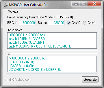

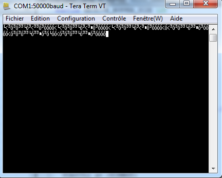

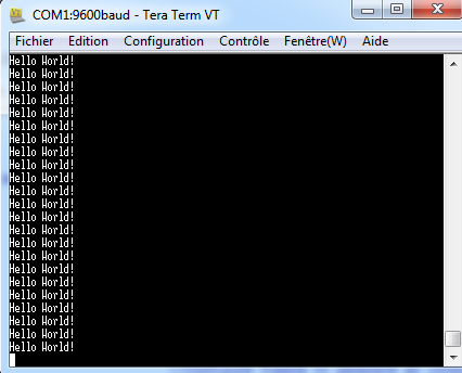

I got a new project with a MSP430FG4618/F2013 and i'm trying to communicate with my PC using a RS232 9-pin connection. I use IAR Embedded Workbench IDE and i use Tera Term to read the message on my computer. I read all the subjects on this forum and on the documentations and i found the three registers UCA0BR0, UCA0BR1 and UCA0MCTL. I understand what they does after reading all the docs. I tried to send at 9600, 14400, 38400 and 115 200 and it works. Now, i want to fix my baud rate to 288k (company rate) but i can't receive my message properly on my PC. For the registers, i use this site :
I use a code i found in this thread : I just wanted something to send to my PC :

  UCA0BR0 = 0x1B;                //Set bit Rate to 288kbps with a 8Mhz clock
  UCA0BR1 = 0x00;
  UCA0MCTL = 0xBB;

Thanks in advance.
