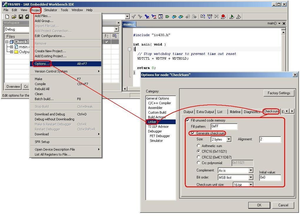

I have one application output file say update.txt and it has starting data as,
@5800
5C 52
@5805
FF 01 00 1A 5F FE 5C 0B 5D 01 00 00 00 19 50 05
00 01 00 1A 5F 0C 5D 0B 5D 00 00 00 00 19 50 06
I got the checksum by enabling it in IAR.
here 5C 52 is the checksum and from @5805 data will get start. In the code I am calculating the checksum by using below logic,
uint16_t hwCRC(char p, int len)
CRCINIRES = 0;
for (p = 0; p < c; p++) {
CRCDI_L = *p;
return CRCINIRES;
My update.txt file will be 128 KB size , iam passing 400 bytes of data at each time and getting the crc , again passing 400 bytes and adding the previous CRC to present. like that iam doing for full 128 KB and making that as a final CRC.
Here i tried passing the value from @5805 , tried by passing only data that is after 5805 but still i am getting wrong CRC at the final, can anybody suggest where i am going wrong..?
  • You hardly give us anything to go on. My initial impression would be that you're not computing your checksum in the same manner that IAR tool is.
    You mention that you are adding the CRC results of each 400-byte section together. Typically not done that way - the previous CRC result should be used to seed the LFSR for the next computation block.
  • Thank you for the replay,
    Could you please explain how implementation has done in the IAR tool so that i will get full idea.? If any documents are there it would be so helpful.
  • You should be able to look that up in the IAR documentation installed with your tool.
  • Attach here .txt file for CRC calculation, and I will add CRC result for MSP430 reverse and non-reverse bit order, to see if this is somehow related to IAR.
    I have checked my code by passing the some values and verified with the CRC calculator in online. i checked by as you suggested to put the seed to the next CRC calculation, value Below are the test scenarios,
    a) passed '1' (0x31) got the correct value as CRC calculator,
    b) Passed '2' , and passed the CRC of '1'  as seed, i got 0x3DBA from code. i verifed the same by passing '12' at a same time in the CRC calculator.
    But i am not getting to calculate the CRC to my downloaded file, from where i need to pass the data. file starts as,

  • Please post the .xcl file you are using. A lot of the answers depend on how you have the linker configured, and that is also the stage where the checksum is computed with the IAR tool.
    Also, please use the "Use rich formatting" link in the bottom right corner of the Reply Box, and use the attach file instead of copy/pasting the text.
  • Hi thank you for the replay. Below is the attached linker file which i am using. I am having a doubt that even if are calculating the CRC for some other data(for example copied text data in previous replay) , do we need to allocate memory for that too?

  • MSP430FR5969 chips do not have hardware checksum.
    IAR you talked about is a PC software. It calculates a checksum according to a algorithm used by that PC software. It has noting to do with the MSP430FR5969 hardware.
  • I am using this code to calculate CRC, this is from Hardware checksum calculator ..are u saying that the algorithm which IAR using is PC software and it wont be same as below hardware logic .. right?
    uint16_t hwCRC(char p, int len, uint16_t seed)
    CRCINIRES = seed;
    CRCDIRB_L = *p;
    return CRCINIRES;
  • There was never any mention of a hardware checksum. Original post even includes the code and method he is using to try to match the IAR embedded CRC.
    This is fairly standard practice in industry for the code to validate itself (or have a bootloader validate the application before calling it).
    EDIT: Let me clarify: 1 - the code posted does use the hardware checksum module, and 2 - the FR5969 sure does have a CRC16 module in it. Check the datasheet.
  • I am confused by the XCL file you posted. It doesn't seem to match your project.
    1) It has linker addresses starting at 0x4400, whereas your example TXT files show placement starting at 0x5800
    2) The CHECKSUM segment looks misplaced
    3) There are not IAR directives in there for memory fill and checksum generation
    Are you sure you posted the correct file?
  • I think you need to use the Reverse registers to match the IAR algorithm. Comparing my soft implementation that matches IAR (I cannot share it, it's company IP) to the description in SLAU208 document leads me to believe that endian-ness is part of your issue.
    But the subject of the posting is "Hardware checksum for MSP430fr5969"
    Almost any checksum can be generated by both hardware or software. There is no such thing as "The hardware checksum" unless you are talking about a specific hardware.
    Aside from being used to "validate itself", CRC may also be used as a "digest" of the version of the code. I am not sure, but I suspect IAR meant the later and not the former; and that is why they do not need to disclose the algorithm used.
  • thank u for the replay,
    I have generated the CRC in on application code by enabling in IAR(CRC16, 2 byte etc) and allocating some memory. this is which i have sent u previously.
    Now i am trying to calculate that CRC(which is 5c52) in some othere application code in which i have not allocated any memory because i dont want any CRC to be placed for the present application, i want to calculate previous application CRC in some other. I want to validate one application CRC in other application code. please suggest.
    Yes, you are correct. My bad.
    No, this isn't correct. It's meant as a checksum, and they document the algorithm right in the "xlink.ENU.pdf" linker document that you can read by selecting "Help"->"IAR Linker and Library Reference Guide" from the menu bar in the IAR IDE. It's the -J option. List all the generation options (1, 2, 4 bytes; 16 or 32 bit, the Polynomial used, bit reversal etc). It's all there in black and white pixels.
  • The xcl file you posted did not contain the -H and -J directives. So I have no idea how the IAR tool generated that 5c52 checksum. Without that information, I can't help determine what is wrong with your code to try to match that checksum.
    You are right, IAR did document how it is done. Not only that, when the user tries to enable its generation, the way it will be generated is right in view for the user to pick and choose. There is no need to find and read the document. There is no need to look at the xcl file or anywhere else. The original poster somehow turned a blind eye on this screen and wasted a lot of time and effort. I mistakenly assume that he did the due diligence.
    P.S. Aside from being used to verify the Main Flash contents, a CRC checksum may be used as a crude Digest to identify the Main Flash image. Even a 16-bit CRC has only 0.0015% of change to miss identify two different images as identical,
  • OCY,
    You are correct. I kind of got a little wrapped up in how I am used to it being done, that it never occurred to me that he just set it in the GUI (which saves the settings to the .ewp project file) instead of coding it in the .xcl command file.
    Where I work, we put all those settings into the .xcl file and that's why I asked for that. If you have multiple checksums on multiple checksum ranges you have to put the options in the .xcl file.
    Several comments back I noted that endianess could be the problem. The polynomials between IAR's CRC16 and the MSP HW CRC module are the same but I think (from reading documentation) that the bit order isn't.
    Anyway, I haven't seen an update from Sachin lately on this thread, so he either figured it out, gave up, or is tackling other problems and will come back to this.
