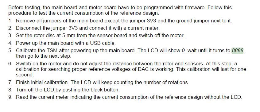

I am using an old version of EVM430FR6989 (Main Board Rev 7). Using the preload code to test the Gas/Water meter. This board always get stucked and display 8888. Is there any rules while this chip doing the calibration, like how to place the motor board.  How can I solve the stuck problem?

    Finally, take a look at the TI Design for this part. Section 6 contains a description of the test setup and how to get it operating correctly:

    1. The board in my hand is different from the one on the User Guide
    2.The FR6989 on the board is a sample chip, and can not be programmed
    3. I have applied new FR6989, and replace the old one on the board. And debugging it right now. If there is any problem, I will make you noticed.

    The motor board needs to be centered in front of the sensor and the distance is limited. I guess, you tried to put the motor board close to the sensor and it is as well not working?! Also the distance needs to be fixed, so don’t move the board during calibration and also not afterwards.
    By the way, which sensor board are you using?
    Tobias
  • Hi Tobias,
    The sensor board is 90º LC sensor.And what is the exact distance between the sensor board and motor board?
