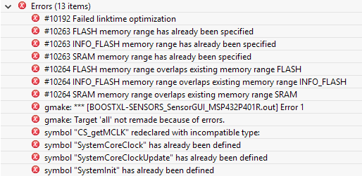

I've tried using the example "BOOSTXL-SENSORS_SensorGUI_MSP432P401R", but without success, because the program hangs in the following code from readI2C():

  • Hi! I cannot compile the code. It says:
    Description Resource Path Location Type
    gmake: *** [src/demo_sysctl.obj] Error 1 BOOSTXL-SENSORS_SensorGUI_MSP432P401R    C/C++ Problem
    ERROR! at line 48: [E0001] Address must be of a non-global defined in the current section
    bne.n SysCtlDelay
    If I comment the code in "demo_sysctl.c":
    /*#if defined(ccs)
    __asm("    .sect \".text:SysCtlDelay\"\n"
          "    .clink\n"
          "    .thumbfunc SysCtlDelay\n"
          "    .thumb\n"
          "    .global SysCtlDelay\n"
          "SysCtlDelay:\n"
          "    subs r0, #1\n"
          "    bne.n SysCtlDelay\n"
          "    bx lr\n");
    #endif*/
    then I get several errors (see attached image).
