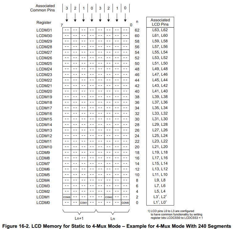

FR4133 LCD COM port
FR4133 LCD COM port should be started at the even line,
for example, if  my  lcd has four COMs,COM0,COM1,COM2,COM3,so i should assign COM0 to L0 or L2 or L4....
am i right?
