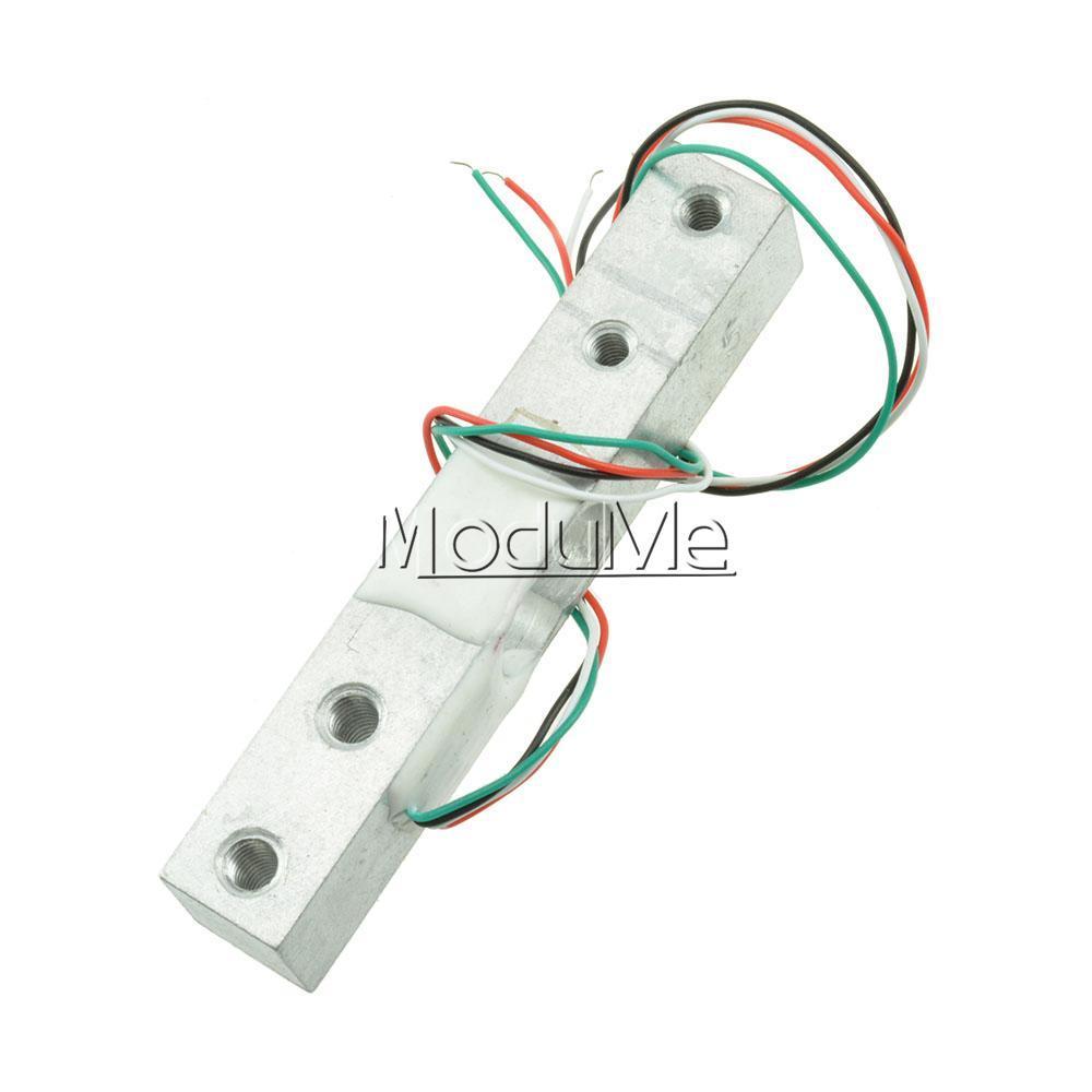

I need to use a single full-bridge weight sensor (5Kg) and was wondering if I can just measure the load using the differential 16bit signature-delta converter in the 430F2013 directly without external amp? I /don't/ need great accuracy or resolution (128 levels would be plenty). Looks like the output impedance is just over 1K.  The application includes to weigh a bottle (& its contents) to determine if 1/4, 1/2, 3/4 and full - the installation will be calibrated with an empty/full bottle so absolute weight is not needed - just relative to max/min. I've picked up on the F2013 as its available in simple packages that I can solder and has a differential AD - if there is a more suited product please advise.

  • This is an example of the type of low-cost sensor I'm considering:
    www.ebay.co.uk/.../252572469572
  • As you said, this type has a minimum of 1k input resistance which is not within spec for the MSP. You might need to add an external buffer or feed in an external reference (max. 1.5V) that also drives the bridge. There is about 1mV/V output span for full load, so you would have 1.2mV when sourcing it from 1.2V - not much, but possible. The PGA of the MSP430F2013 has a maximum of 32, so this would mean 38.4mV/5kg which is 7.68mV/kg. The 16 bit converter has a resolution of ~18µV at 1.2V reference, so at least in theory you would have a resolution of 2.4g, not bad, but noise will be your contrary with that low voltage levels.
