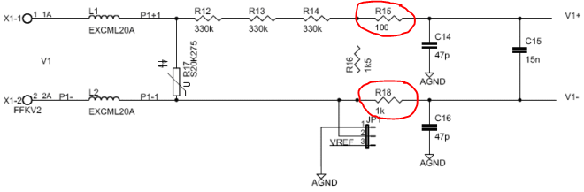

  • Hi Alan,
    What values are your anti-aliasing resistors on the positive and negative sides for the voltage input? If they increase the input impedance too much, they'll cause a large phase shift that your present configuration can't correct.
    James
    MSP Customer Applications
  • Hi James,
    This is the schematic of my application regarding the voltage and current input.

    As you can see the measurements done with value 'x' inside the register are exactly the same when done at 'x+256'.
    As specified in slau461 (section 1.2.10) it is specified that the range for the preload register is 0-1023, instead in the slaa577 in 4.3.2 it is specified that the maximum step is 256.
    Do you have any suggestion on how to resolve this issue?
    Thanks for your help.
  • Hi Alan,
    Thank you for these measurements. It's very helpful for our discussion.
    The preload applies a fractional sampling delay, not full integer sampling delays. Since we're sampling the input signal (assuming it's a 50 Hz signal) at 4096 Hz, each sample takes 1 / 4096 Hz which equals 244 us per sample. Now, for one cycle of the 50 Hz signal, there's 360 degrees total, and it takes 1 / 50 Hz which equals 20 ms. Assuming you need a phase shift of 8 degrees, this equals 8 degrees * (20 ms / 360 degrees) which equals 444 us. Now, one sample takes 244 us, so 8 degrees phase shift essentially means you need to delay by 444 us / 244 us which equals 1.82 samples.
    Since the preload register can only delay by a fraction of a sample by utilizing the modulation clock (here it's 1.048576 MHz), a maximum preload value is 256 because one sample takes 244 us and 1 / 1048576 * 256 equals 244 us. As you can see below at an expected phase angle of 30 degrees, you measured 25.57 degrees both at preload values of 25 and 281 (which is 281 - 256 = 25). Basically, the preload value is overflowing because it's trying to delay more than 1 sample.
    Thus, I'd recommend manually delaying the samples for the full integer delays. If your current channel is 8 degrees behind the voltage channel, delay the voltage channel samples by one (manually in the code) and then the remaining 0.82 fractional samples using the preload register. In the code, I'd recommend storing the existing/present voltage sample and using the previous sample with the existing/present current sample to accomplish this. Does this make sense?

  • Hi James,
    I now understand better how the preload register works. I tried delaying the whole samples and there were improvements in the calculation.
    Thank you for your help!
