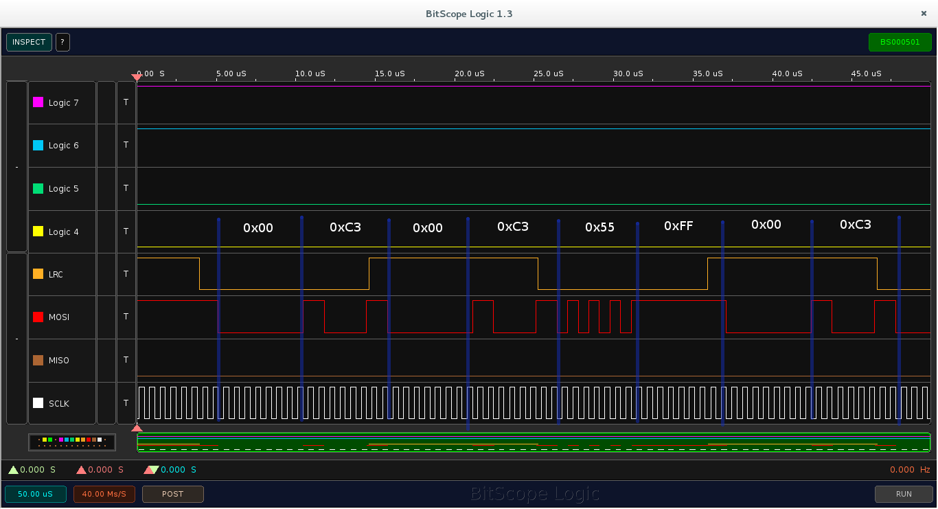

    Now my SPI sends continuously. To check that the bytes were sent in the right order, I gave my output buffer the following value :
    int8_t AudioDataOut[4]={0x00,0xC3,0x55,0xFF};
    So the 4 bytes to send are easy to recognize. But here is what it actually sends : (look at the MOSI line)
    It should send : 0x00 - 0xC3 - 0x55 - 0xFF - 0x00 - 0xC3 - ...
    And it sends : 0x00 - 0xC3 - 0x00 - 0xC3 - 0x55 - 0xFF - 0x00 - 0xC3 ...
    It looks like the DMA sends the two first bytes twice before they send the two last bytes !
    (and the LRC is dephased, I'll fix this later by resetting the counter ...)

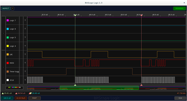

  • Using RX instead of TX solved the bytes-disorder issue. Thank you for the advice about the control register, it's good optimization.
    It almost works, the bytes are sent in the right order. The SPI clock is not contiguous, but it might not be an issue, the most important being to synchronize the transmission over the sampling frequency. I did this using a timer. The DMA interrupt only disables the DMA, the timer interrupt sets up the DMA control register and enables the DMA.
    It looks like this :
    The only issue is the external counter (sourcing LRC), which is does not start from zero for any reason (I reset it at the beginning of the program). I will try to manage this pin without the external hardware, with the scatter-gather DMA, or with an internal timer used as a counter (that may be simpler ?).
    By the way, I'm using a WM8731L codec, which I have chosen because the following board exists : http://www.mikroe.com/add-on-boards/audio-voice/audio-codec-proto/
