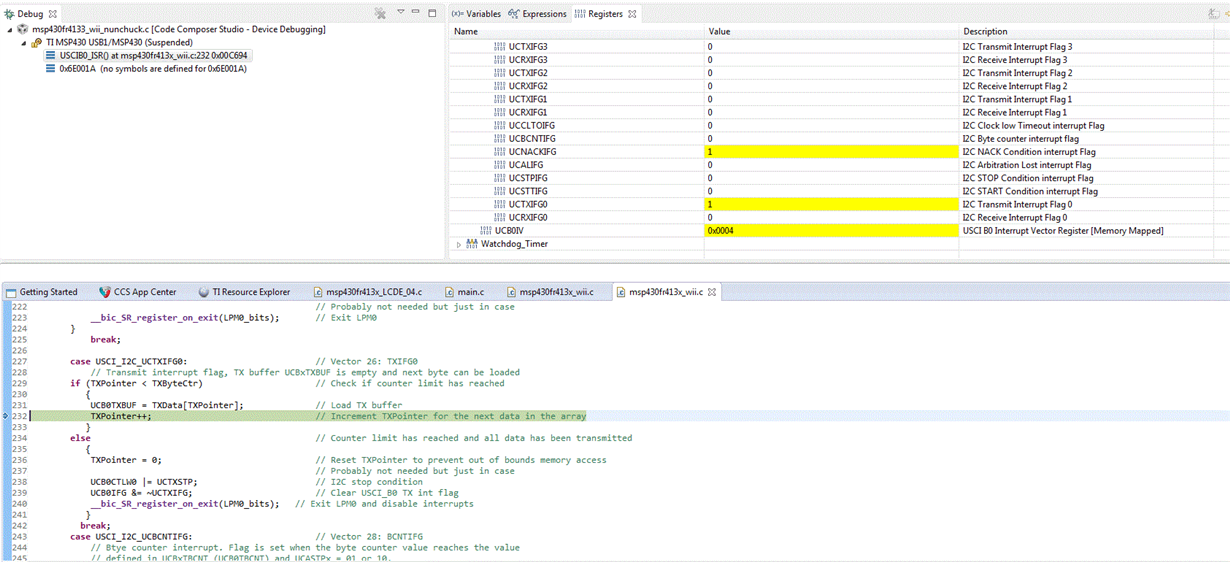

I  am currently using a MSP430FR4133 and trying to use interrupts to interface with a wii nunchuck.  I have referenced heavily from 2 different I2C examples provided from MSP430Ware (msp430fr413x_euscib0_i2c_10.c and msp430fr413x_euscib0_i2c_15.c) and reproduced the following code attached.

However, as I attempt to run the code, it seems to hang sometimes when I enter LPM0 during TX.  Other times it gets through it but hangs as I attempt to read it.  What I want to verify is whether or not this is a code issue or a hardware connection issue.
As I am running out of ideas, any help on this would be greatly appreciated.

    The actual slave device is the black Wii nunchuck and I have SDA and SCL connected to P5.2/UCB0SDA and P5.3/UCB0SCL respectively with 10k pull up resistors.  I am also using the 3.3V and gnd from the launchpad to power and ground the nunchuck.
    As for where the code hangs I now believe it is as you described:
    "You also never write the register number that you want to read from after initialization, on some slave devices it will continue to increment the register address until an overflow or invalid address occurs."
    Since it seems that when I first try to run the code after reset it enters the nunchuck_read() function but fails to trigger the USCI_I2C_UCRXIFG0 interrupt flag. (Currently it actually enters the USCI_I2C_UCTXIFG0 subroutine before it eventually hangs)
    I will attempt to correct my code with the changes you described but if you have some insights to the couple questions above it will be a tremendous help.

    Unfortunately it still seems to hang when it enters LMP0_bits with GIE in nunchuck_read(). It seems that it never receives a USCI_I2C_UCRXIFG0 flag.
    However I am now having suspicion that I am not correctly transmitting the handshake protocol in nunchuck_init() to begin with. As I step through the code in the debugger, I noticed that as I am transferring bytes while in the USCI_I2C_UCTXIFG0 routine, I get a NACK interrupt flag, in which case I send the I2C start condition again similar to the example code.
    case USCI_I2C_UCNACKIFG:                            // Vector 4: NACKIFG
    UCB0CTL1 |= UCTXSTT;                           // resend start if NACK, I2C start condition
    break;
    I not entirely sure and please correct me if my assumption is wrong, am I clearing the buffer and trying to transmit the next byte even though the wii nunchuck has not acknowledged the data?   I realized now as I was following the state machine diagram in the user guide (Figure 23-12) that the UCBxTXBUF is discarded when UCNACKIFG = 1. If this is the case, is this a hardware set up issue or is this the while loop issue you mentioned in the beginning?
    I have also been trying to reference example code using the MSP430 + nunchuck but I have been unable to find one that uses interrupt vectors.  The closest one I have been referencing from interfaces the MSP430G2231 with the wii nunchuck and servo motors but it uses USI I2C instead of eUSCI.
