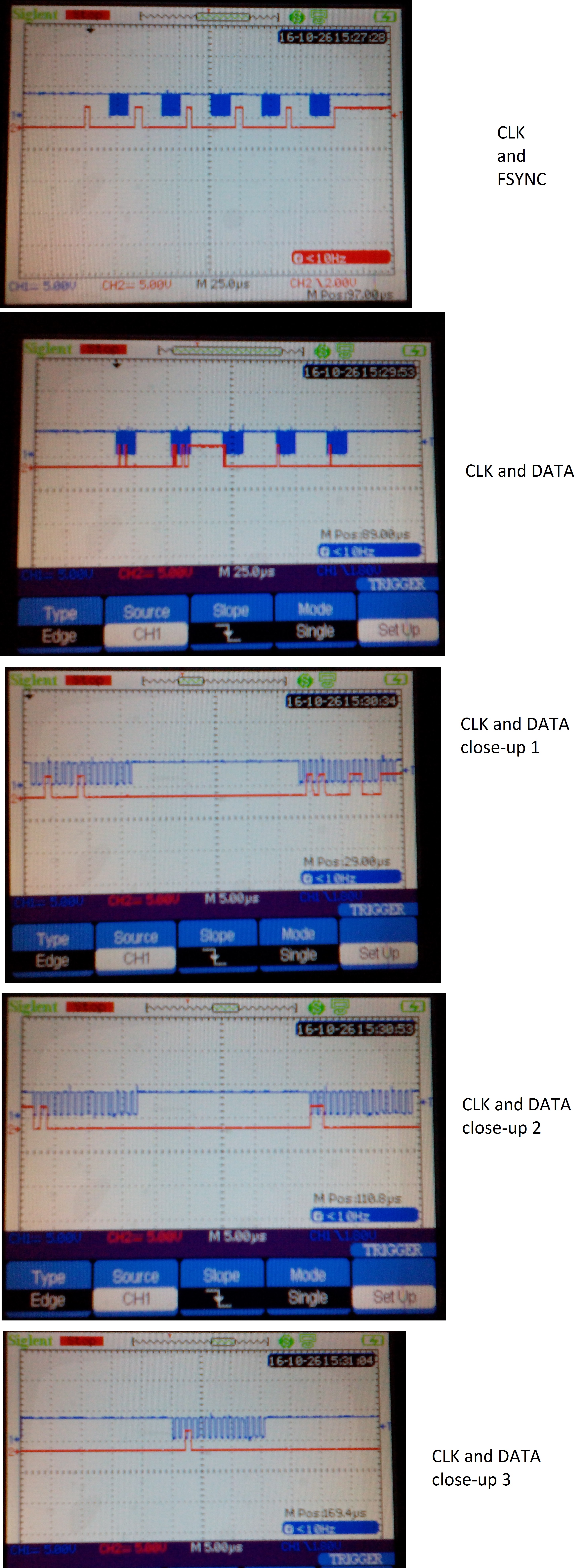

Hello! I'm using a MSP-EXP432P401R Rev. 2.0 Launchpad to program an AD9833 programmable waveform generator. The problem is that I cannot get it to generate anything.
My SPI configuration is the following (SPI mode 3 with 1 MHz clock):

I've checked the SPI waveforms and I can confirm that the data is transmitted as described in the application note. I have attached my schematic and screen captures. From the captures you can see that the data is transmitted correctly (I used delays of a few microseconds). In the schematic, at DDS_Vout I get a DC voltage, around 1,1 V.
Does anybody have an idea about what could be the problem?

    Data can only be transferred when FSYNC is low, I assume this is controlled by CS_PIN/P4.0. Serial data is shifted into the input shift register of the device on the falling edges of SCLK. Your initialization however sets the SPI for EUSCI_B_SPI_CLOCKPOLARITY_INACTIVITY_HIGH and EUSCI_B_SPI_PHASE_DATA_CHANGED_ONFIRST_CAPTURED_ON_NEXT, which means that the data is changed on a high-to-low transition and captured on a low-to-high transition. Your SPI settings are therefore out-of-phase, you need to either change the clock polarity to inactive low or swap the phase select settings in order to communicate with the AD9833.
    Ryan
  • Thank you, Ryan! That was the problem. I guess I was too annoyed by it to notice the incorrect configuration.
