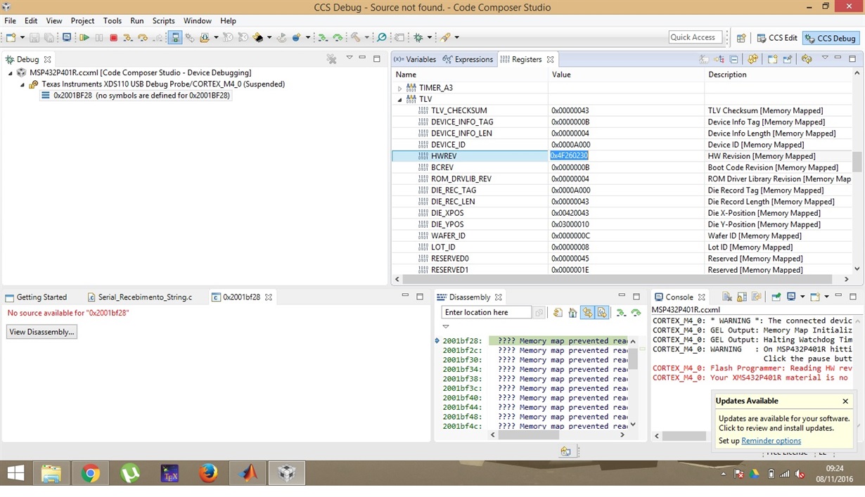

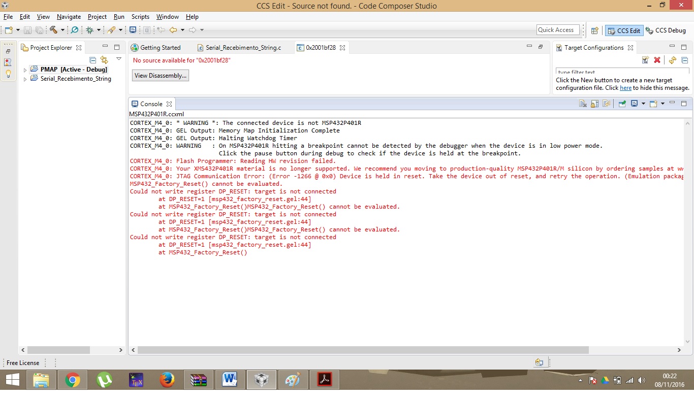

A few days ago i received the new version of the Launch Pad ( i already have the black version ) and as i tried to flash the new version i received this messages:
Flash Programmer: Reading HW revision failed.
Your XMS432P401R material is no longer supported. We recommend you moving to production-quality MSP432P401R/M silicon by ordering samples at www.ti.com/product/MSP432P401R.
File Loader: Memory write failed: Unknown error.
I already saw this discussion (link below) about something similar and executed the steps suggested, but i still receiving the same error message.
https://e2e.ti.com/support/microcontrollers/msp430/f/166/p/548350/2002063?pi318617=5
Another thing to point ou is that i mainly use the cloud based ccs, so i expected that it was fully updated with the new version of the board, appearently it is not ( i even uninstalled my browser in hope that the cloud ccs plug in was updated after the reinstalation and all, but unfortunatelly it was not).
Any suggestions?

  • Actually i already tried the factory reset of the microctroller. My CCS appearently performed the reset well, but since it was hanging during the building/flashing i was unnable to really make sure the microcontroller was funcitoning after ther reset, at least in the desktop CCS. Then i made the reset procedure again ( in the desktop app ) but then i decided to flash the device through the cloud application. The first time after the reset, appearently, it flashed the device but it was not performing the program inserted which is a modified version of the Port Mapping exemple from the resorce explorer, the LEDs in P1.0, P2.1 and P2.2 are supposedly to blink but they were not. Then i decided to try flash the device again in the cloud application, but the this time i recieved the same error message.
    I also tried to flash the device through the cloud application in my desktop computer in the lab that, but i received the same error message.
    I am currently re-installing the desktop application in my personal copmuter so i can perform the identification of the hardware version described in the link you apointed and then i will try again to perform the factory reset.
    Thanks.
  • Well, i re-installed the CCS desktop application ( the i tried to flash a firmware in the board, red version, and again the error massage...then i tried to flash the black version, it worked like a charm!!!) and performed the hardware identification....by the posts on the link you gave it was not at all what i expected, below is a picture of what i found.
    So, as you proposed, i performed the factory reset, as described in www.ti.com/lit/ug/slau597b/slau597b.pdf  and the result is shown in the picture below.

  • Hi Antonio,
    sorry for the trouble you had so far. It indeed looks like an error in the TLV data (which is why the tools reject it as unknown). 0x43 is the correct one for Revision C, which is why your friends boards are working. Could you give us the exact labeling of the MSP432P401 device? (or another picture where this can be seen).
    I will check with Chris how your board can be replaced.
    Thanks and regards,
    Thorsten

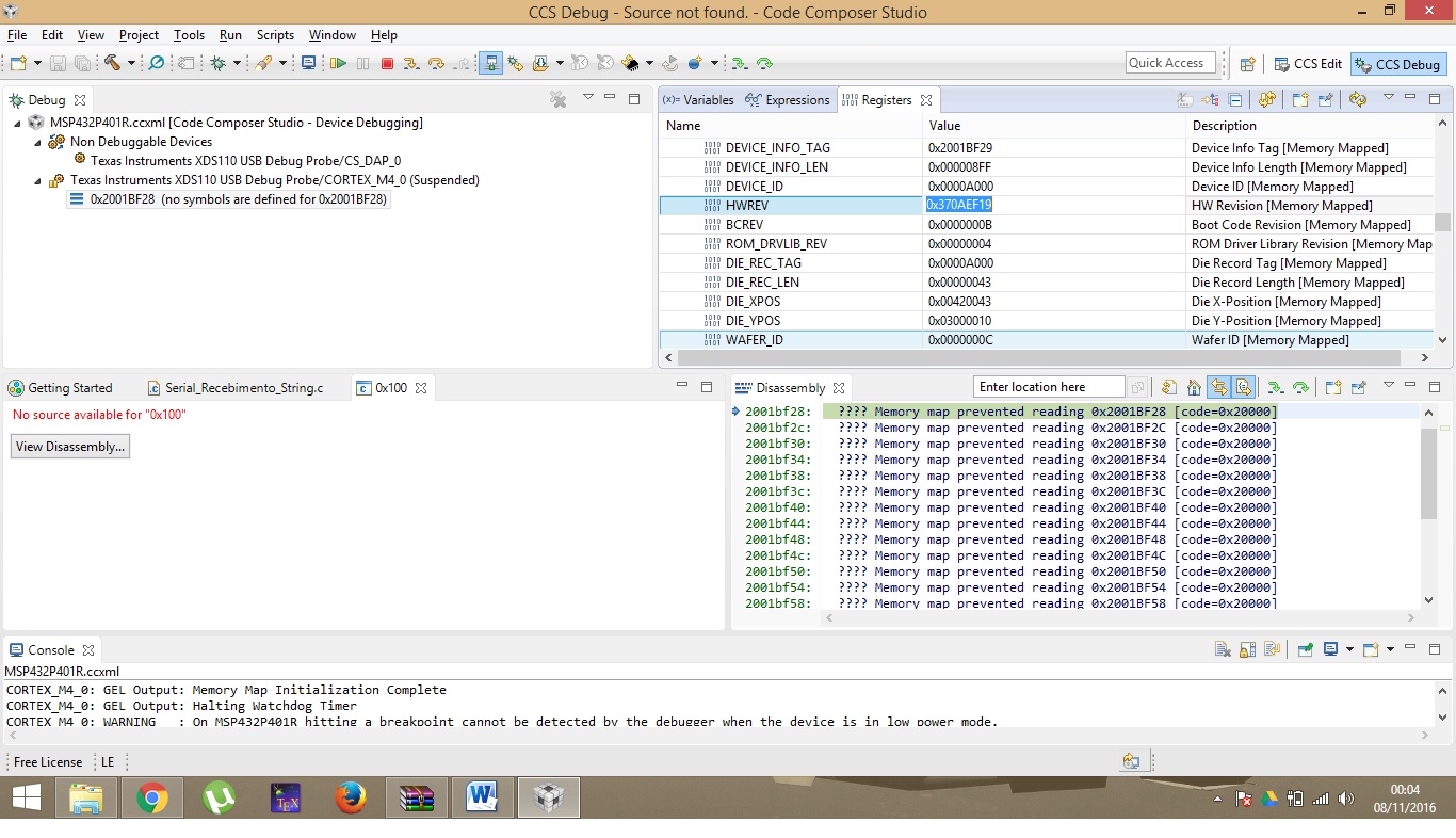

  • Hi Thorsten,
    i took the liberty to check the third board we bought, just in case something is wrong with it too. So i unpacked it and went to flash the device, surprisingly it flashed. The program i flashed is comunicating through the eUSCI were i write #two_digit_number and it returns tow_digit_number. The problem is, the firmware was returning #two_digit_number. So i guessed something was wrong, then i went to flash the program again. And gues what, it gave me the same error as the other board. Then i checked the hardware number, it's show in the picture below.
    Let me ask you, it is possible that CCS is somehow misreading the TLV_HWREV number or even modifying it?
    I ask because is really strange that it flashed the device, even with a firmware that is not behaving correctly ( and for the record i flashed it in the black version and the firmware is behaving correctly ) and then in the secont time the program behaves like the TLV_HWREV is something other than the numbers of the suported versions of the board, so the first time it identified it correctily and then misread/changed it.

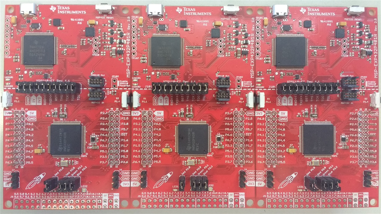

    Below is a photo of the hardware. But it is the third board (not mine) because i forgot it at home when i came to the lab. But as far as i remember, the labels are the same XMSP432P401R REV C as shown in the pecture below ( if really need for both boards i can take a picture later).
    Thanx for the support.
  • Hi Antonio,
    thanks a lot for the picture - that helps us nailing that issue down.
    By using eUSCI, does your tool use the boot strap loader (BSL) for programming the device? Then it would be clear why programming is working - the BSL uses the correct routines for programming the device and does not need to check the HWREV.
    If you want to program with a debugger we need this information, as there are some differences in flash programming RevC and older HW revisions of the XMS samples.
    The TLV data is written during production and is read only - so there is no way to change this. It could be that the data is read out incorrectly by the tools, but I do not believe that.
    For the moment, can you live with programming the device via USCI? (Debugging would also be an issue)
    If you have the chance could you additionally give as the labeling of the other two devices (at least of the one with the same issue)?
    Thanks and regards,
    Thorsten

  • Here the picture of the three boads. The first on the left is the functional one.
    *a detail of the third board on the right
    the readings on the chip:
    flashable: 63AHK2WG4
    not flashable: 62ARX1WG4 / 62ARX2WG4

  • Yes i can program, in KEIL's IDE, and the TLV_HWREV shows the correct number, 0x43 for both boards that were not flashing in CCS. But as i said, the same firmware that callibrates the DCO runs in Rev 1.0 but not in Rev 2.0, if i flash a firmware that doesn't callibrate the DCO it run just fine. And the fact that KEIL have limited code size unfortunately is not a valid argument because i flashed both Rev 1.0 and Rev 2.0 with the same code.
    Still cannot flash with CCS, as it throws me the same error mesage. CCS was already reinstaled, with a pack that (at the time of the installation) was 3 days old so...
    But, it'a really strange that KEIL is reading the correct version of TLV_HWREV, but in those links you send i think one of them was about CCS misreading the TLV_HWREV, i will check it more carefully for some further information.
    But it's also really strange the fact that some firmware runs in both Revs and other don't, yesterday when i was playng with it i noteced that when the firmware reached the DCO calibration function instead of executing que code in the function it was jumping through some code that i didn't recognized (something about the startup/system code i guess, it was late at night so i didn't really dit into it) this is why i think is something about the DCO calibration.
