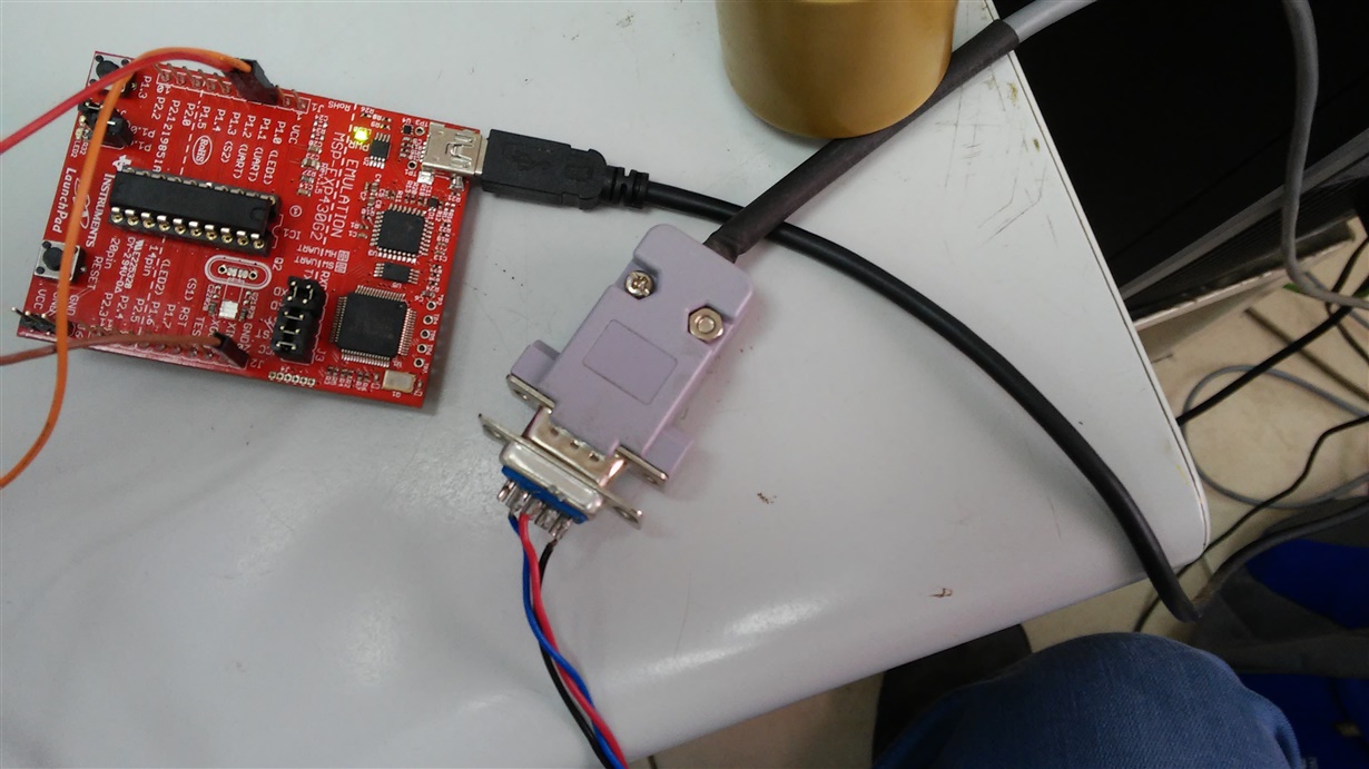

    about the RS-232  converter i'm don't use any converter i have a db9 connector from the pc(COM1) i've attached an image of the circuit
    the cables color from the pc's db9 to the mcu are as follow:
    black -> brown
    red -> orange
    blue -> red
  • If that DB-9 is connected directly to the PC serial port, and then directly to P1.1/P1.2, you shouldn't(!) do that. The levels are probably at least 5V, which can damage your MCU.
    If you find a different way to connect directly to the MCU pins, you should remove the TXD/RXD jumpers from J3 so the USB UART bridge doesn't interfere.
    Is there a reason you're not just using the USB UART bridge on the Launchpad?
  • The levels are 3.5V, maybe i need to reduce it (how can i do it?)
    The jumpers RXD/TXD were horizontal, vertical and remove, and the response stays the same.
    what do you mean by USB UART? is that the usb attched for the power?
    I need in the future to be able to communicate with RS-232 (both transmit and recieve), from slau144j.pdf to do so, i need to use the UART function in pin 1.1 and pin 1.2 (there's no mention of USB UART) nd from the quick start guide the jumpers of TXD/RXD needs to horizontal.
  • 3.5V should be fine (Vcc on the Launchpad is 3.6V). That isn't like the PC serial ports I used to use. (RS-232 is +/- 12V, so even +5V is "cheating".)
    The USB UART is called the "Application" or "back-channel" UART in SLAU318E. Yes, it runs over the "power" USB connection. When you plugged in the USB, Windows should have created you a COMx port with the name "MSP Application UART" (or similar). You can use that COM port with your terminal emulator (9600bps only) . The TXD/RXD jumpers connect that to the P1.1/P1.2 pins.
    If you're connecting directly to the port pins, you should remove the TXD/RXD jumpers from J3, otherwise the programming/bridge chip (TUSBxxx) is also driving those pins. (see also SLAU318E sec 4.3)

  • I managed to dig up a G2 Launchpad (Rev 1.5) with a G2553 in it.
    Using your code and the Application UART, talking to Win8.1 PuTTY set to 9600-N-1 (no flow control), I get 'a' (or whatever) every time.
    The suggestion is that whatever it is, it is outboard of the Launchpad -- wiring, Host side, or procedure.
    Unfortunately, I can't try those. This is where an oscilloscope comes in handy.

  • If Device Manager says that your "MSP Application UART" is COM7, then that is what you should give to your terminal emulator. Configure it as though it were an ordinary COM port. (Be sure to turn off "Flow Control" if asked.)
    Since you're running P1.1/P1.2 through the USB (not through your wiring), you should install the J3 TXD/RXD jumpers, and remove your wiring from the pins. The TXD/RXD positions will be rotated (90 degrees) from the others.
    I'm pretty sure that all of this is described in SLAU318E.
