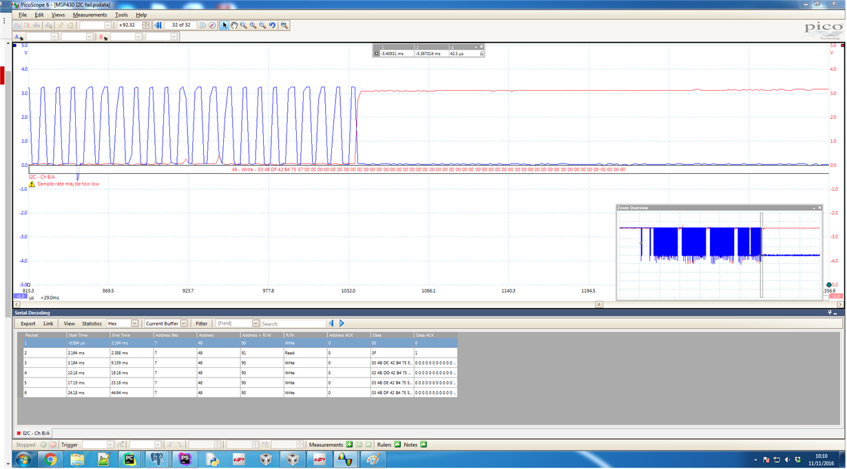

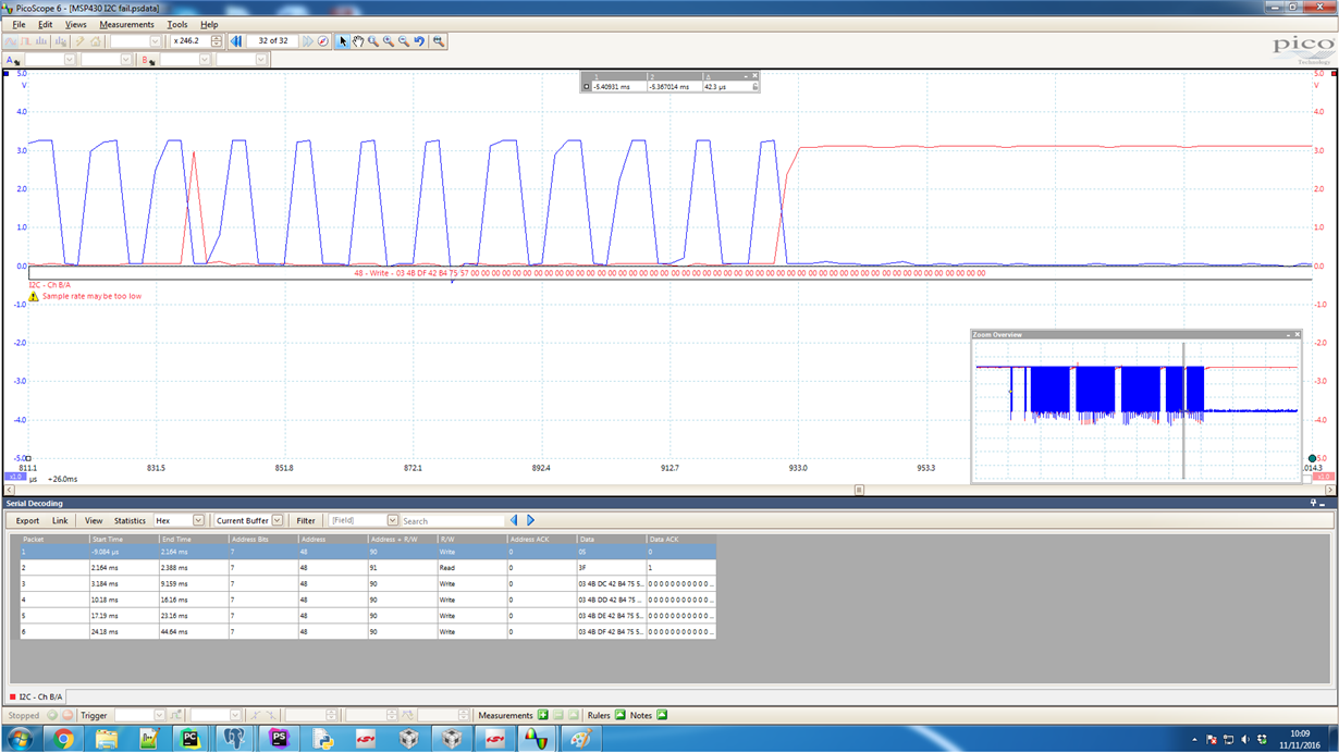

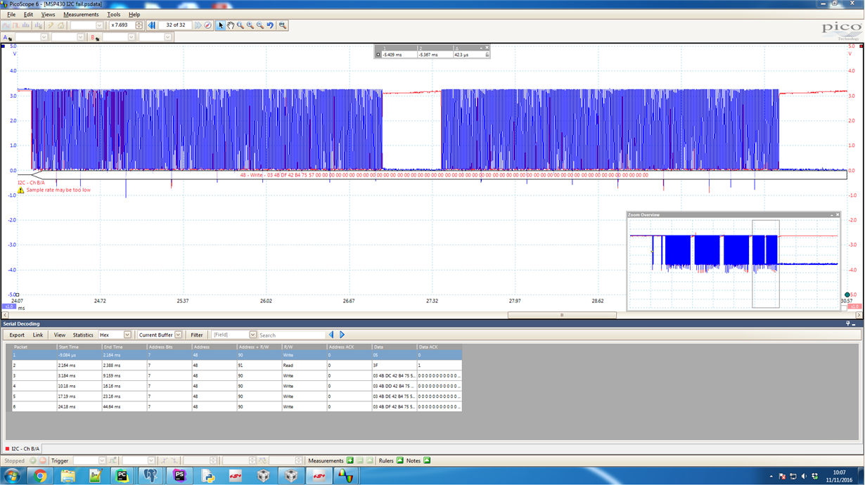

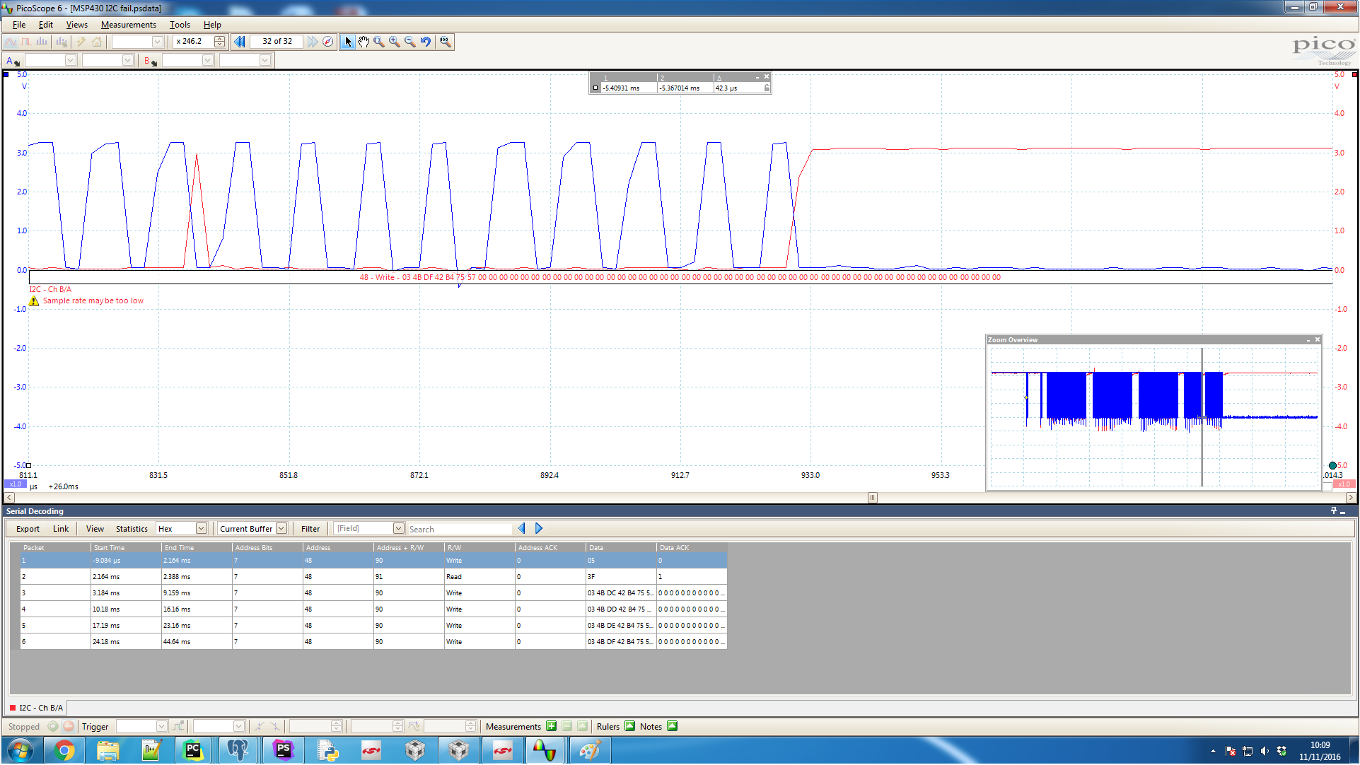

  • Currently I have a Picoscope set up so I've attached three images of an example of the packet before the msp hangs during an example run of my program. First pic is the full 62 byte packet (0's are expected since the data coming from the master is just dummy data). The gap in the middle I'm not sure if it's an artifact of the picoscope or whether it's something real that's happening. In any case the second image is a zoom of that and the final image is a zoom of the end of the packet, where the clock goes low and stays low.

  • My mistake on the UCTXIFG state, I had forgotten that it is set when ready to transmit new data. You can disregard my previous post.
    Since communication is valid for several minutes it is definitely worth investigating some of the I2C-related errata. USCI30 is doubtful as the UCBxRXIFG is serviced very quickly and efficiently, but perhaps the wake-up time from LPM4 is involved? You mention LPM0 in the latest post, maybe you should try this low-power mode to see if anything changes.
    USCI39 could possibly be an issue since the GIE is reset and set each time an ISR is entered and exited, respectively. But this would assume that UCSTTIFG, UCSTPIFG, or UCNACKIFG are set while you are servicing the ISR, you could check the status of these flags during interrupt operation to be sure or try the suggested workaround.
    If the last bit of the last screenshot is a slave ACK then it would appear that the MSP430 is still operating properly, in which case there may be some confusion between the master and slave as to who should be sending or receiving data. If you can detect this state on the master end then you should be able to compensate by at least re-starting the I2C lines and re-sending the packet, not ideal but a possible workaround.
    Ryan
