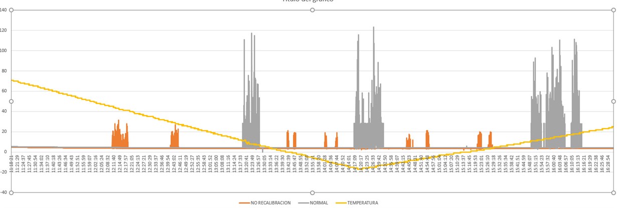

When the FW is running in standby (no metal presence) we have a mean current consumption of about 3.8uA. Approaching metal to LC resonant circuit, excites a state change and MSP raises the current consumption up to about 10-20uA for short time going down again to 4uA.
The fact is that we have tested in climatic chamber over the temperature range (+70ºC to -20ºC) and we have detected that MSP current is not stable at 4uA. We have registered the current consumption of 2 boards over temperature (one with recalibration routine active and other without) and there are current peaks without having any kind of reason.
We also have tested in sleep mode (no LC sensing) and the current stays stable at 4uA.
Knowing that, we have we have recorded a video where we have heated coils, capacitors and MSP (around LC sensing HW pins) and we have noticed that heating coils or capacitors has no effect and heating MSP current consumption rises.

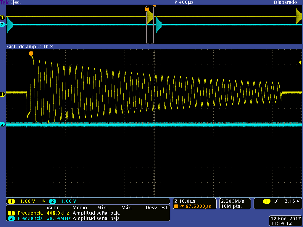

  • Hi Ruben,

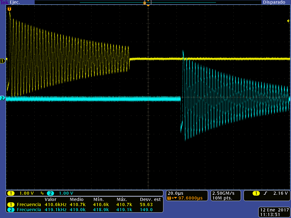

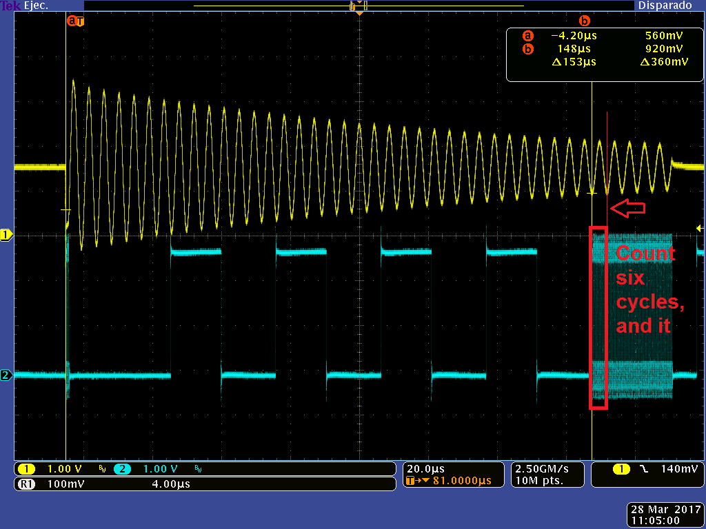

    Have you been able to monitor the LC sensor oscillation variations across temperature? I believe that the current spikes you are observing are due to the fact that the MSP is waking up due to incorrect transition detection.
    Once you obtain oscillations variations there are somethings you might want to try:
    1. Analyze the the LC sensor oscillation variation and determine the type of frequency and amplitude oscillation changes you have across temperature.
    2. Based on the analysis of the LC sensor oscillation variations determine if the analog hysteresis in the ESI module need to be adjusted to minimize the effect of temperature on the coils.
    If adjusting the hysteresis of the ESI module does not solve the problem an alternative could be to develop a calibration routine using the msp internal temperature sensor and recalibrate the TSM registers and ESIDAC registers taking into account the ambient temperature.
    Ivan

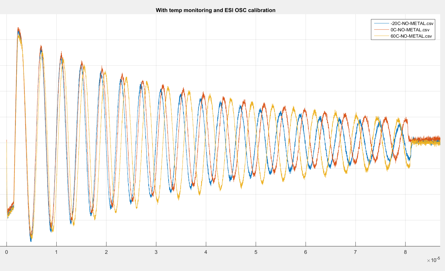

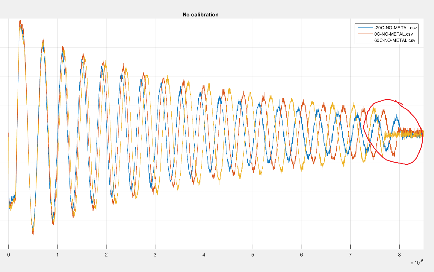

  • Hello Ivan,
    Comments on obtaining variations of the oscillations to determine frequency and amplitude and thus adjust if necessary the analog hysteresis in the ESI module.
    The amplitude variations were observed on an oscilloscope by applying heat / cold directly on the MSP, but we do not have quantifiable data on the internal measurements of the MSP.
    We have performed tests on 4 circuits (without metal), with several temperature ramps and it has been observed that in all of them there are changes of state but in an apparently random way, that is to say at different temperatures, and also do not affect equally the MSP.
    The calibration and hysteresis (AFE1) we use consists of a mean between measurements with and without metal in the LC.
    The recalibration (AFE2) will adjust this calibration and hysteresis, if applicable, after n turns, but never otherwise.
    The reality is that if changes of state are detected both by changes in the detection or not of metal and also by temperature changes there is a risk that the counters ESICNT0, ESICNT1 and ESICNT2 count in error.
    We do not intend to perform a calibration adjustment without actual movement, what we want is to identify the wrong state changes (by temperature changes) to not take them into account.
    We know the problem, but not how to attack it. It should be noted that in reality the position of the needle (metal) on the LC can be any.
    What we want is to orient us to find a solution. In the event that we had to enhance medications such as making and registering.

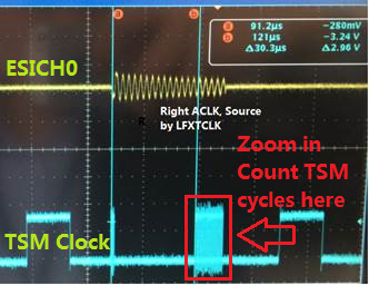

  • Hi Ivan and Ryan,
    We have been analysing the LC signal behaviour while it is heated/cold.

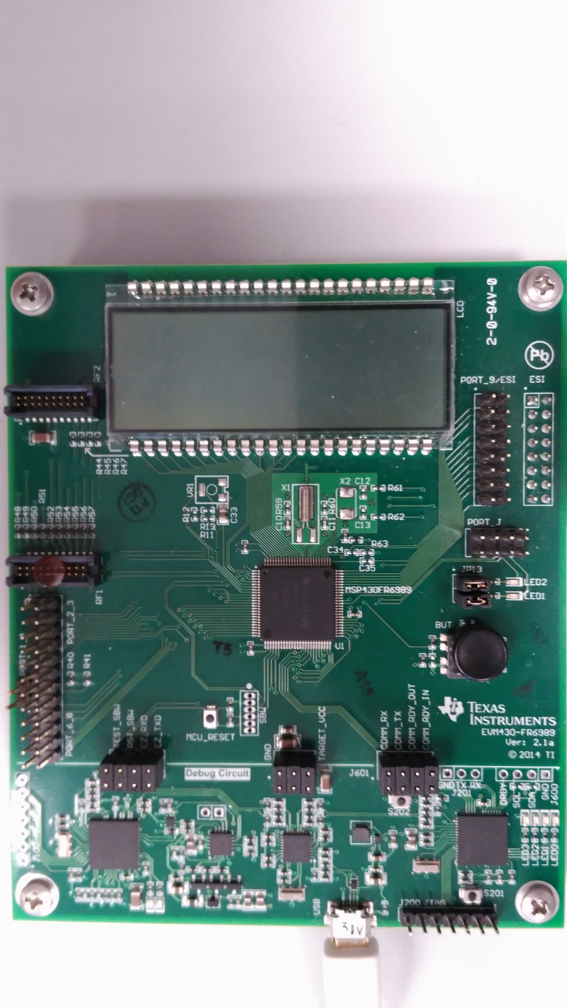

    We have just noticed that internally MSP430 is triggering the ISR when it is not supposed to be interrupting.
    Knowing that our board and our software has been developed by us, we have tried to do the temperature cycle in the climatic chamber with the EVM430-FR6989 ESI FLow EValuation Module provided by TI with the original FW provided also by TI:
    Water Meter Reference Design for two LC Sensors, Using Extended Scan Interface (ESI) in
    « www.ti.com/.../TIDM-LC-WATERMTR Documents »

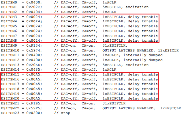

    We have modified the original FW just to have the counter of how many times the ISR is triggered during the temperature cycle.
    For testing purpose, we have modified as follows (Attached documents):
    -           Main.c
    -          ScanIF.c
    With this modification, LCD shows:
    -          First line:             rotation_counter
    -          Second line:       interrupt_counter
    All the added or modified code lines contains // JMM interrupt_Counter to easily find out.

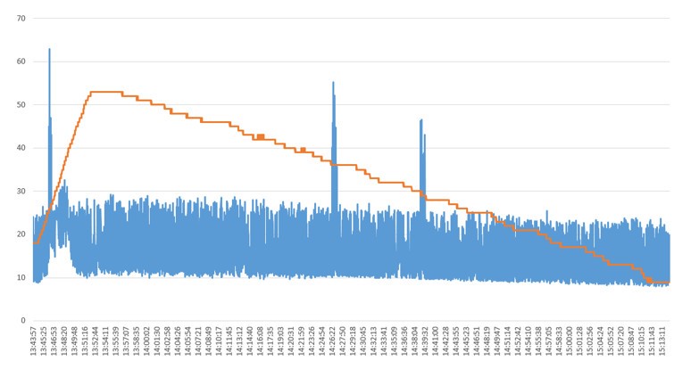

    During the following temperature cycle, we have registered about 400 undesired interruptions (see trace image):
    -          Yellow trace: temperature
    -          Blue trace: current consumption
    In terms of ISR counting register:
    -          ISR Initial Counter: 204
    -          ISR Final Counter: 603 (see attached image)
    As you can imagine, we are not able to put this equipment in production (we have manufactured the second prototype phase and we are just to launch first production) as far as we cannot model this behaviour.
    This equipment is battery powered and having this uncontrolled ISR enter with the associated current consumption, forces us not to continue manufacturing and trying to work around it.
    Unless we are not able to solve this issue, we will be forced to choose another platform from another vendor which fulfils our needs.
    Many thanks for your comprehension.

  • Hi Ryan,
    The application note of the LDC1000 sensor confirms that temperature changes affect the resonance impedance and the inductance and therefore the oscillation frequency.
     According to this we have two problems with the temperature variation:
    - interruptions due to changes in state and therefore consumption.
    - it is more than likely that if the frequency changes can be counted wrongly.
    It is right?

  • Hi all,
    We have been following with additional tests over temperature using TI Development Kit.
    In our first tests, we have used a high gradient temperature cycle (2 min per degree) which is not very common in our application.
    We have modified the cycle to have 2ºC/h, which is much more common.
    Starting at +20ºC we have reached +2ºC in 9-10h aproximately and the MSP kit had about 100 ISR entries counting at the starting point due to calibration process.
    With this profile we have realised that ISR false triggering had been increased hugely comparing to previous tests.
    We have also tested with our modules and ISR entries counter are in the same scale:
    DUT 1: 17533
    DUT2:  19866
    We are going to test it again in order to validate the test and have more data to analyse .
    I hope this results could give some more information to go further in your investigations about this issue.
    Many thanks

  • Hi Ruben,
    Ivan has been able to reproduce the issue using a EVM430-FR6989 and test chamber. He is currently validating a temperature calibration routine.
    Ryan

  • Ruben,
    We need to get profiles of of your LC tanks' oscillation frequency and amplitude changes over a range of temperatures. Can you put these together for 3-5 of your sensor boards?
    We have a working theory that temperature is effecting the oscillation characteristics of your sensors, such that the the oscillation threshold is crossed, a false state transition is detected, and therefor the interrupt is fired. This may somehow be aggravated by the calibration routine. We will be conducting some tests to help prove this on Monday morning CST.
    The idea is to establish temperature transition points at which the oscillation threshold needs to be re-calibrated to compensate for the thermal effects on the sensors. Temperature could be detected by using the internal temperature sensor.
    Another, less probable, solution is that we find a new oscillation threshold that works across the needed temperature range.
    Let me know if any of that is unclear.
  • Good morning Cameron & Ivan,
    Once the firmware is loaded in the Kit and after the calibration, a couple of captures are made on the oscilloscope.
    If you need some measure in the catch (amplitude in some point, etc) tell us.
    I want you to confirm that this is what you want to send you, before performing the tests in climatic chamber.
    Jose Miguel
  • Hi José Miguel,
    Yes, those are the oscillation we are looking for. Could you please obtain oscillations at -20C, 0 C, 20C, 40C and 60 C. With at least 3 different coils?
    Thank you,
    Iván
  • Good Morning,
    Sending the oscilloscope captures to different temperatures made to 3 modules + the kit.
    You can see in these captures how the signal changes.
    But without data (ADC) it is difficult to quantify.
    Would not it be better to perform ADC measurements for each temperature ???
    If so, you would have to modify the firmware of the Kit to display this measurement on the LCD. Perhaps using the pushbutton.
    You will comment

  • Hi Ruben,
    We want to start testing some calibrations options on your board. However we are having problem re flashing the board. We have tried using 4-pin JTAG configuration and Spy-bi-wire configuration and both modes are failing.
    Could it be possible to get the correct procedure to reflash the boards. I am using the MSP-FET tool and CCS to reflash the board.
    Ivan
  • Hi Ivan,
    We use the MSP-FET430UIF tool and CCS (Code Composer Studio 6.2.0) to reflash the board.
    We use "Signal Connections for 4-Wire JTAG Communication".
    We have created an adapter the MSP-FET430UIF connector to the board.
    Attached images of scheme and adapter used.
    Jose Miguel
  • Hi Jose,
    Thank you for the information. Now I am able to load code to the board.
    In my case it consistently takes 2 retries before the CCS is able to load the program.
    Ivan
  • Hi Jose,
    Please find an update below.
    The figure below shows the oscillation of the LC tanks in your design with out any type of re calibration.
    As you can observe in the figure above, changes in temperature will affect three main factors in the design:
    1. ESIOSC frequency will drift due to temperature changes. (This is shown in the circle in red). This is the reason the oscillation stops at different point in time.
    2. LC tank frequency drift due to temperature. This impacts the TSM calibration.
    3. LC tank decay rate increases at low temperatures. This impacts the ESI DAC configuration.
    Currently we have a fix for item #1. We have added a calibration routine which monitors the internal temperature of the MSP and triggers a recalibration of the ESIOSC when the temperature crosses predefined thresholds. The LC tank oscillation with ESIOSC recalibration can be observed in the figure below. Next week we will to tackle item 2 and 3.

  • Hi Cameron,
    Attached image of the "EVM430-FR6989 Evaluation Kit"
    I have tried removing jumper jumpers from J402 and J601 and some from J401. The report has been wrong.
    The "EVM430-FR6989 Evaluation Kit" was connected to the PC with USB-MciroUSB, but we had never connected through MSP-430FET430UIF.
    It asked if the firmware could be transferred to the kit via "MSP-430FET430UIF".
    I connected it through J200 (JTAG) without success since this JTAG goes to the "MSP430F5528 COMMUNICATIONS BRIDGE".
    Any suggestions?
    Do you have the test firmware implemented in our hardware?
    Jose Miguel

    Follow up to 3 modules (calibrated and counting correctly at room temperature 25ºC)
    Climatic chamber tests were performed with two different profiles:
    - Rapid profile (total 2h45 '): Drop from 30ºC to -10ºC and rise to 30ºC with 2ºC / Minute.
    - Slow profile (total 15h15 '): Drop from 30ºC to -10ºC, rise to 65ºC and drop to 30ºC with 10ºC / hour.
    Tests have been repeated several times.
    The results of one of the tests were:
    First: No counting (no iron on the coils) to check for interruptions due to gAPP_interruptCounter status changes (and consumption peaks)
    - Quick profile: Interruptions in modules 5500, 6200, 2000
    - Slow profile: Interrupts in modules 59334, 9812, 22768
    Second: Modules on meters in rotation at different frequencies, to check counting.
    - Quick profile: The modules have been counted less (for example, in 22,000 laps, 1,000 less, 65,000 laps less than 14,000)
    - Slow profile: Modules have been counted less (eg in 100,000 laps, 43,000 less, in 747,000 laps 64,000 less)
    At the end of the test (at room temperature), sometimes modules, in the air (without iron in the coils) detect that they are with iron ???,
    And in this situation the cases have occurred:
    1) Being in the air (without metal) have come to count or to discount.
    2) over counter in rotation no longer count.
    In these cases, they need to be reset (TSM restart) to maintain their initial calibration.
    A correct test: A module after a slow profile test, has counted 480,000 turns correctly and was still working correctly.
    In these conditions we can not accept the correction as valid.
    If you happen to some type of test or some modification in the firmware tell us.
    Waiting for your news.
    Jose Miguel

  • Hi Jose,
    The TSM register I mean is not exactly the same as the setting routines.
    This routines can set TSM working at the temperature you calibrate it. But when the temperature changes, we need to adjust the TSM register to capture the right data.
    How to adjust the TSM:
    1. Output the TSM clock(by P1.3)
    2. Capture ESICH0 and TSM clock in one photo
    3. Count how much cycles of the TSM clock are needed to sampling at the right point
    4. Do step3 at -20, -10, 0, 10, 20, 30, 40, 50, 60 degC, record the numbers of cycles
    5. Do a liner approximation, then adjust the TSM registers once we get a temperature data
    The TSM is set after a Reset with:
    Void ScanIF_Calibration_TSM_Auto_cal (void);
    And added the routines of "IKOR_Project_EVM2" where the TSM is readjusted according to the temperature (in three sections> 40ºC, <-10ºC and rest)
    The counting of the clock cycles of the TSM, I suppose you realize it without metal in the LC.
    Do you think that adjusting the TSM based on measurements in one circuit will fit all the others?
    Jose Miguel
  • Hi Jose,
    The results should be similar if you use the same kind of LC sensor and the same kind of board. That differences will not influence the measurement.
    Cash Hao

  • Hi Jose,
    That's a good sign if you see the differences.
    ESI, we have a TSM(Timing State Machine) to set at which time we should start sampling. We are using registers ESITSM0~ESITSM23 to set it up.
    In this settings we are sampling the point at the end of six ESIFCLK(sum up from ESITSM3~ESITSM8 or ESITSM15~ESITSM20). It refers in the photo below.
    What you need to do is to count how much cycles of ESIFCLK it needs to sampling at the right point when the temperature is changing. Then change the ESITSM registers according to the temperature.
    Hope this will help you!
    Cash Hao
