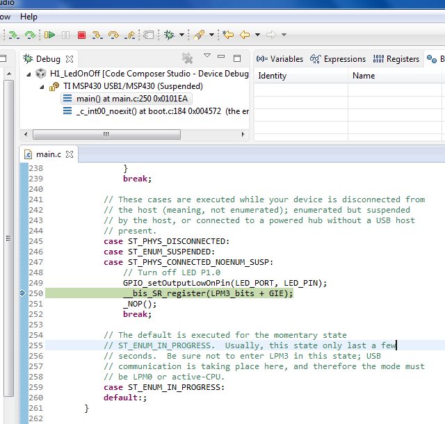

I am interfacing USB with  MSP430F5529 controller.In that i designed USB part schematic same as in the slaa457.pdf(USB design using MSp430) but i am not able to Program Properly.In MSP430F5529 LP it was Programming well,and I am dumping code from USB developer package(i.e HID H1 LED ON/OFF) working well for launchpad not for my USB interface.When i start to debug the code it was Strucking permanently in the main.c as in below switch case
        switch(USB_getConnectionState())
            Case ST_PHYS_CONNECTED_NOENUM_SUSP:
        _bis_SR_register(LPM3_BITS + GIE);          //-->>HERE I AM STRUCKING FOREVER

    When i programmed USB code for HID led on/off to my board MSP430F5529 i am strucking in
    case ST_PHYS_CONNECTED_NOENUM_SUSP:
                    // Turn off LED P1.0
                    GPIO_setOutputLowOnPin(LED_PORT, LED_PIN);
                    __bis_SR_register(LPM3_bits + GIE);
    _NOP();
        break;
    Thanks in advance
  • Hi Beeresh,
    I think what you're seeing is the device going into LPM3 at the line 250 of the code and when you press pause on the debugger it "looks" like you are stuck there but you really aren't, you're just in a low power mode and the CPU isn't running. Can you run the USB HID Demo that is available in the TI Resource Explorer and see if you can connect to the device and send commands?
    Also, I recommend taking a look at the Example Guide: MSP430 USB API Stack for a description of how the USB examples work.

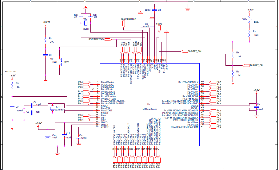

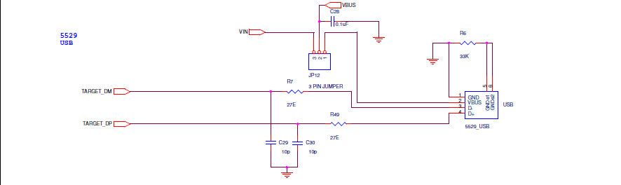

  • Hi  Clemens
    Please refer my USB schematic  as per in the slaa457.pdf(USB design for MSP430).Take a look tell me sir any issues in hardware.please refer attached schematics of USB and Controller Part.In USB Schematic i am SHorting Jumper JP12(1,2).

  • Hi caleb
    I attached the Schematics of both USB and Controller Part. can you Suggest me the is there any hardware issues?
    Thanks in advance
  • I do not see any obvious error in the schematic.
    How does this device look like when the host tries to enumerate it? (Look at the system log of a Linux host.)

    7.I have to make any changes in hal.c/hal.h/descripter
    Since you have an 8MHz crystal then you will have to change the following values in descriptor.h file:
    #define USB_XT_FREQ_VALUE 4.0 // Indicates the freq of the crystal on the oscillator indicated by USB_PLL_XT
    #define USB_XT_FREQ USBPLL_SETCLK_4_0
    to:
    #define USB_XT_FREQ_VALUE 8.0 // Indicates the freq of the crystal on the oscillator indicated by USB_PLL_XT
    #define USB_XT_FREQ USBPLL_SETCLK_8_0 // Indicates the freq of the crystal on the oscillator indicated by USB_PLL_XT
    So are you still getting the Error 403 message? Or are you getting USB Device Not recognized when you hook up the USB to the host?
    Arthi
  • Hi Arthi
    Thank u very much...it worked when I correct crystal frequency to 8Mhz
