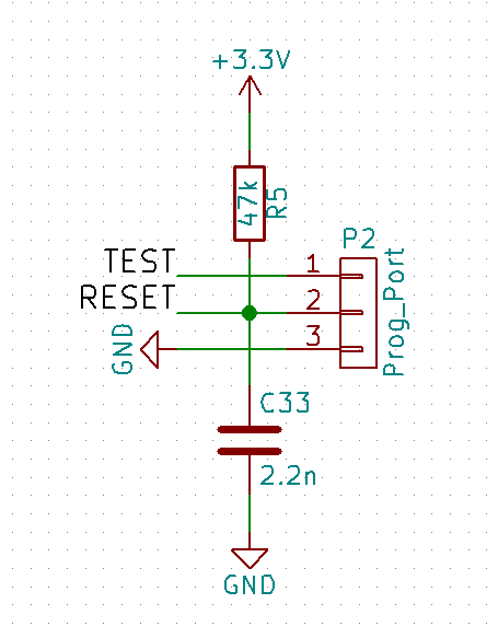

I am attempting to debug my program onto an MSP430G2553 using CCS 6.2.0 through a LaunchPad and I am receiving the above error message every time. The chip itself is surface mounted onto a custom PCB with a connector for the test/reset/ground pins. I have checked the continuity of each of those traces and I have confirmed that the board is receiving power (3.3V on Vcc) as well as being properly grounded.
The weird thing is this PCB is an exact carbon copy of a previously used board, also using the MSP430G2553, and I have no issues debugging my code onto that one.
At this point any advice would be very much appreciated! Thank you for your time.

    I have a suspicion that your issue may be due to not having the proper capacitance and resistance necessary for programming via SBW. Check out the first response to this previous E2E post: MSP430G2553 Does Not Recognize MCU
    Also, if you could provide schematics that would be very helpful.
    Caleb Overbay
  • Hello Caleb,

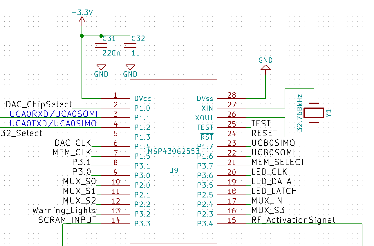

    The board was actually designed with that in mind, I've included screenshots of the relevant schematics below. I also thoroughly tested each capacitor and resistor before soldering it to the board, so I am relatively certain that is not the source of my error.

  • Hi Stephen,
    It's good to see you anticipated this when designing the board, and everything appears as if it should work.
    Let's try some more debugging to try to find out whats going wrong:
    1. Do you have any other boards that are exhibiting this behavior or is it just this one?
    2. Is it possible VCC is dipping during programming?
    3. We typically use a 1.1nF cap in place of C33 to enable high speed SBW communication. The 2.2nF is the upper limit when using current tools. You could try reducing this capacitance and see if anything changes.
    4. Your capacitance on DVCC looks a little low. Can you try using a 10uF and 100nF for C32 and C31 respectively?

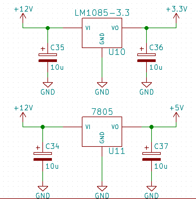

    4. There is actually a 10uF attentuating capacitor located by the 3.3V regulator for this circuit in addition to the 220nF and 1uF capacitors shown above. I've included a picture of that part of the schematic below.
    The LM1085-3.3 is the power supply for the MSP430G2553 in this case.

                             i had developed a customized msp430 g2553 board  few months ago for my college project. At that time  i was using msp fet debugger to program(spy by wire) the device and i too got this problem first . in your circuit diagram shown where you have connected 2.2 nF on reset pin, i had 10 nF   on my reset pin and i was getting error could not find the target device. then i changed it to  1 nF and it worked later on i tried  to program with launchpad  it also worked.  try this if this help.
