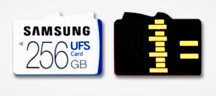

  • Martin Risso said:
    I have looked at some of the newest eMMC giant flash chips and they specifically say they do not support SPI mode.
    Marty,
    If you are talking about support in your devices of such type of non-SD-certified flash cards like this one:
    ...I would say, you will not get access to it even through 1.8V 4-pin SD-mode. So, even the C5545 is not a choice for such type of 'flash memory' cards.
