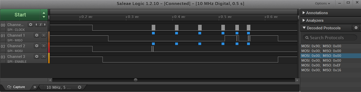

I'm hoping someone will be able to point me in the right direction. I'm working on getting my MSP430F5529 to read the device ID from a WinBond Flash device. At this point, I am able to successfully send the command to read the device ID and have the flash chip reply properly (I have verified this with a signal analyzer).
My issue however, is that the device ID and manufacturer ID always return 0. Any idea why the MSP would be confused about what value is coming into SOMI when electrically the right bits are on the line?

For reference, here is a screen grab of the signal analyzer:

  • Hi Paul,
    After looking over your code, I think your problem is in the SPI_SendRecieveData function. More specifically, the for loop that reads from UCA0RXBUF.
    In this for loop you are immediately reading the buffer after placing the dummy byte in UCA0TXBUF and not giving the device enough time to actually transmit the dummy byte and receive data. Placing while (!(UCA0IFG & UCTXIFG)); just after the write to UCA0TXBUF should solve your issue.
    Try this out and let me know if it solves your issue.
    Caleb Overbay
  • You must not read RXBUF without checking for RXIFG first.
    And SPI always both sends and receives, so RXIFG will also be set after each of the first four bytes.

  • Hi Paul,
    To know if everything is initialized correctly, I'll need to see into the functions you use in SPI_Enable:
    1. SPI_ClockMode
    2. GPIO_Set/ClearBits
    3. The values of SPI_MODE_1, SPIDOUT_MSP, SPIDIN_MSP, and SPICLK_MSP
    Also, I never saw you enable either the transmit or receive interrupts for the SPI module. Without these enabled, I would expect a statement like while(!(UCA0IFG & UCRXIFG)); to just spin forever.
    Edit: Disregard the last statement. The interrupt flag will still be set regardless of whether interrupts are enabled.

  • As I said, RXIFG is still set from the previous for SPI transactions. You'd have to wait for the fourth byte to be received and then to clear RXIFG before doing the two actual reads.
    And it might be a better idea not to split the function into separate write+read parts; just write and read six bytes in both directions.
  • Thanks Clemens. I threw the below line in between the two for loops to clear the flag:
    UCA0IFG &= ~UCRXIFG;
    Didn't seem to change anything....I'm still perplexed. I'll take a look at how to write some nice code that does everything all at once, without the seperate read and write.
    -Paul
  • Hi Paul,
    That is perplexing that it's not working properly. After you restructure your code, can you let us know if you're still having issues?

    I have verified that this works electrically and I am still seeing the same behavior with regards to my MSP not appearing to store the values being sent in on SPI.

  • Ah sorry - issue is still there, I was just saying I think I fixed not having the RXIFG check. I'll add a line for clearing the register as well.
    Paul
  • Hi Caleb,
    I was able to put a SPI Flash chip on a breadboard and interface it with a launchpad. When I use that set-up, the code works perfectly and the value is stored correctly. I guess the issue must lie somewhere on my hardware then.
    Thanks so much for all the help - sorry to lead you on a goose chase. I do appreciate the code tips and tweaks though, I'm sure it wouldn't have worked otherwise.
