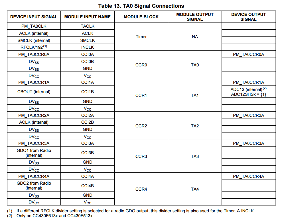

  • I'm using cc430F5137. The INCLK for TimerA0 and TimerA1 for this chip is pinned from the RF transceiver crystal(RFCLK/192). The following is the signal connection from the datasheet: To be clearer, my scenario is: The input of TimerA0 is TACLK(PM_TA0CLK), the input of TA0CCR3 is GDO1from radio.
    The input of TimerA1 is TACLK(PM_TA1CLK), the input of TA0CCR2 is ACLK.
    The application of this scenario is using GDO1 and ACLK to capture the external CLK, where the frequency of GDO1 and ACLK can be measured with respect to the external CLK. As you explained, now I have to spearate the input pin of external CLK for each timer to solve this situation.

  • Bob,
    As seen above Aclck can be an input of TA0CCR2. TA0CCR2 is no way connected or related to TimerA1 for it is a different timer instance. If you want to relate ACLK to the external input you have for TimerA1, you need to use a TA1CCRx that supports ACLK input.
