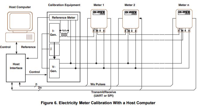

  • Thanks James for your reply,I noticed that it is not a hardware issue after observing the energy displayed on the LCD is constant for a constant load. By the way what is the number of pulse at which energy error is calculated during accuracy test?there are different error result for different number of pulses.the error goes good as i increased the number of pulses from 1 to 2 to 3 to 4...etc.is there any standard on the number of pulses I should set?and what is 'n' on the test document
    shown on  is that the number of pulse?

    In Figure 6 in the Implementing An Electronic Watt-Hour Meter With MSP430FE42x(A)/FE42x2 (Rev. C) User's Guide, "n" is just the number of meters, not the number of pulses per kWh. While this looks like a bus that's n-bits wide, this figure is showing you'd need "n" connections for "n" meters to measure the energy pulses from each one.
